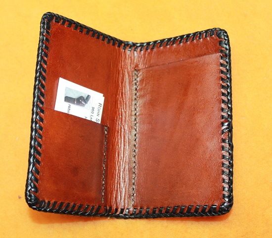

I have carried a memo book and business cards for years and finally got around to making something to carry them in. I did have a bit of trouble with making my lacing look good at the end/beginning. I usually do holsters and never have to meet the lace at the starting point. I'll have to practice on this if I do any more of these or any wallets.
I dyed the leather a light brown and then antiqued it with a dark brown dye from Tandy that I bought years ago. I finished it with Tan Kote then laced it and gave it a second light coat of Tan Kote. of The lace is "RealleatheR" calf lace that I bought from Weaver, and I am impressed with it. The cost is especially impressive as it is about half the cost of kangaroo lace.
Comments and critiques are welcome.

I like it a lot. It'll last for years. Lacing looks good, the ending of the double loop is a touchy area, it can be done but takes some practice and patience. That's another reason I like the Mexican Basket Weave you commented on in another post, it closes a lot easier and neater than the double loop.

Thanks for the nice words Chief. I am about to start on a wallet and I will learn the Mexican Basket Weave on it for sure.

Looks good, not easy to do this lacing job....never did much of it....need to start practicing..well done !!

I use the double loop lace all the time and after 30 yrs I still have trouble with closing. I always try to find a place sort of out of casual view in case I don't get it just right. I have found it's easier for me to begin/end on a corner. That way you can disguise a foible, if necessary. The case looks great and will last a long time. What did you use for the liner, it looks good?
Tip
Tip, Thanks for the nice comments. The liner and inside pockets are from 2-3 ounce leather the back is 4-5 ounce. I dyed the inside with Fiebings mix of Saddle Tan and Light Brown Oil dye.
