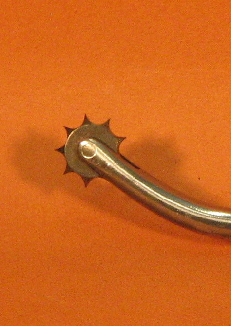

The overstitch wheel is used after sewing to clean up the backside stitches. Yes, you need to have the size wheel that will match your stitch length. If you have good wheels with good points they will follow the stitch line even if it wanders a bit. The problem I see is that most of the modern made overstitchers have gotten so poor that the points are shallow and blunt even on the 5/6/7 common sizes. They will not press into the hole or round over the stitch. I have attached a picture of a pretty good old #7 wheel. It'll still do the job 100 years later.
For an overstitch wheel, that one sure is purdy Bruce.
