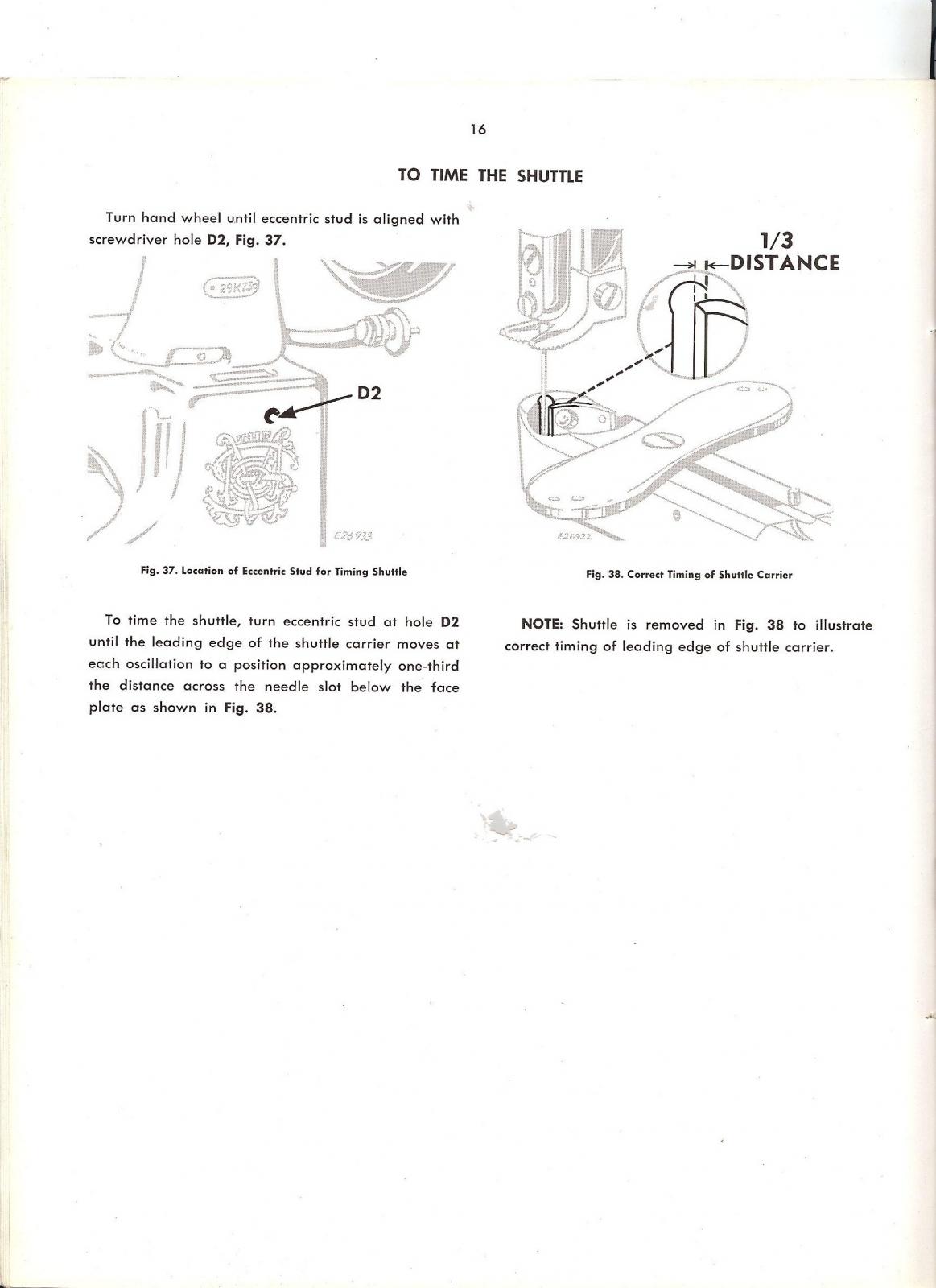

You don't loosen the screw on the gear to retime as this screw must always stay in a hole in the shuttle driver,you loosen the locknut on the opposite end & turn the screw (it's a cam screw) to retime it.
post-7185-0-36907000-1368276659_thumb.jp
Edited by CowboyBob
Bob, that's just what I was hoping for! I did find a part to a manual that referred to this adjustment, but it had no accompanying photo or diagram, so I had no idea what it was about. Your explanation and image is just the thing. I'm very confident I'll be able to get this beauty running.
