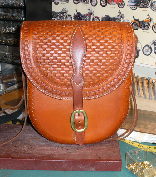

Ian Report post Posted January 11, 2009 Not for a customer, just wanted to make something cowboy-looking Quote Share this post Link to post Share on other sites

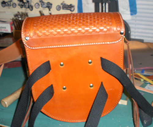

Timd Report post Posted January 11, 2009 Well,I'd say you nailed it. Can we see the mountings? Quote Share this post Link to post Share on other sites
Luke Hatley Report post Posted January 11, 2009 I LIKE THE WAY YOU SEWED THE FRONT OF THE BAG TO THE GUSSETT. AS ALWAYS......... NICE WORK Quote Share this post Link to post Share on other sites
Ian Report post Posted January 11, 2009 Well,I'd say you nailed it. Can we see the mountings? Sure, I'm just going to put a couple of side release buckles on - should hold it Quote Share this post Link to post Share on other sites
Rayban Report post Posted January 12, 2009 That is oor-some...what's the dimensions? With a should strap that would be a kick-ass Man Bag!! Quote Share this post Link to post Share on other sites
Greybeard Report post Posted January 12, 2009 That is one Sweet bag! Quote Share this post Link to post Share on other sites
tashabear Report post Posted January 12, 2009 That is oor-some...what's the dimensions? With a should strap that would be a kick-ass Man Bag!! I agree, except I'd want it for a purse! With the connectors set up right, it could do double duty. Quote Share this post Link to post Share on other sites
BradB Report post Posted January 12, 2009 That looks great Ian!! How did you get the gusset to bend so nicely, did you score it on the inside where you wanted it to bend? Quote Share this post Link to post Share on other sites
McJeep Report post Posted January 12, 2009 And what weight leather did ya use - it looks like a nice blend of flex and strength. I'm getting ready to make one for ma wife's scoot :0) Quote Share this post Link to post Share on other sites
abn Report post Posted January 12, 2009 Nice design and beautiful color. Two thumbs up! Quote Share this post Link to post Share on other sites
Ian Report post Posted January 12, 2009 That looks great Ian!! How did you get the gusset to bend so nicely, did you score it on the inside where you wanted it to bend?Brad, I bent it when it was still wet and it dried like that. Unfortunately smoothed out the border design a bit.And what weight leather did ya use - it looks like a nice blend of flex and strength. I'm getting ready to make one for ma wife's scoot :0)Jeep, that's 8 oz Quote Share this post Link to post Share on other sites
McJeep Report post Posted January 12, 2009 Gracias :0) The bend didn't hurt anything ... gorgeous piece :0) Quote Share this post Link to post Share on other sites
Sasquatch Report post Posted January 13, 2009 Nice work man! Quote Share this post Link to post Share on other sites
MADMAX22 Report post Posted January 13, 2009 Thats a good job Ian. You got a nice color out of it and good stamping. I like the design with the gussets and the gusset flaps as part of the side D mounts. Quote Share this post Link to post Share on other sites
jbird Report post Posted January 13, 2009 very top notch your very skilled at this stuff thanks for posting. Josh Quote Share this post Link to post Share on other sites
Ian Report post Posted January 14, 2009 Thanks again for the kind words, folks. Yes, I love that color too (Fiebings Saddle Tan) NicNice to do something other than black, for me. Quote Share this post Link to post Share on other sites

azrider Report post Posted January 16, 2009 This is awesome. I am getting ready to do some leather for my bike and will be doing all wester styled, and looks like I will be using Saddle Tan. (I have been trying out other colors to see what I wanted.) What did you use to seal the leather in case it gets rained on or anything? Quote Share this post Link to post Share on other sites
Ian Report post Posted January 16, 2009 This is awesome. I am getting ready to do some leather for my bike and will be doing all wester styled, and looks like I will be using Saddle Tan. (I have been trying out other colors to see what I wanted.) What did you use to seal the leather in case it gets rained on or anything? Thanks. It has two coats of Bag Kote and lots of Aussie Quote Share this post Link to post Share on other sites
McJeep Report post Posted January 19, 2009 .Jeep, that's 8 oz Sooooooo I'm hopin' ya don't mind if I plageurize you a bit with that style? The way you mounted the front is just plain sexy :0) Just finished mocking up one for my wife - on to template stage :0) Quote Share this post Link to post Share on other sites
Ian Report post Posted January 19, 2009 Sooooooo I'm hopin' ya don't mind if I plageurize you a bit with that style? The way you mounted the front is just plain sexy :0)Just finished mocking up one for my wife - on to template stage :0) You're not plageurizing at all. I wish I could say I invented something, but sadly that's not the case. Let me know if I can be of any help when you start putting your bag together. Ian Quote Share this post Link to post Share on other sites
