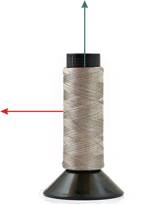

I've found on our sole stitchers, that pulling the thread from the spool differently will impart a twist to the thread. It depends upon how the spool was originally wound.
If you have been drawing the thread from the spool as in the red arrow on pic (with spool rotating), without problems, then changing to drawing the thread off as green arrow (with spool stationary) will cause the thread to twist (or vice versa).
If you haven't changed the way the thread is drawn from the spool, please disregard this missive!

I've found on our sole stitchers, that pulling the thread from the spool differently will impart a twist to the thread. It depends upon how the spool was originally wound.If you have been drawing the thread from the spool as in the red arrow on pic (with spool rotating), without problems, then changing to drawing the thread off as green arrow (with spool stationary) will cause the thread to twist (or vice versa).
Spot on, Terry. Thanks mate. I must have threaded the spool stand differently last time I changed thread colour. Doh... I can hardly believe that moving the thread to another hole less than 2" from the original could have such a huge effect; still, at least it was an easy fix in the end. I was dreading the engineer's bill. LOL
