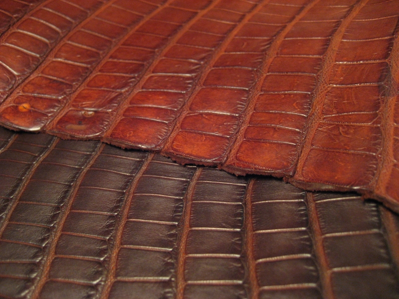

I am just back from a trip to my hometown in Louisiana and decided to visit a local tannery I never knew was right under my nose. They had the nicest selection of alligator hides and I picked up a few to make some watch straps. I have been mostly working with leather hides and have not ventured out into any exotic hides as of yet. Most of the high end straps that I have examined seem to have only the expensive stuff on top and usually backed with leather. Does anyone know what is generally used on the back side of nice watch straps...is it some sort of faux suede or is it some really thin leather. Also, one of the straps I took apart had grey foam padding inside about 1 1/2 inches from the top. Does anyone know what this product is? Before I go cutting into this really nice leather hide, I figured I throw out a few questions to the wise.

In your photo of the gator hide you are showing the tail. The belly is the desirable portion to use. The plates or scales are way larger on the tail portion and are prone to lift and peel over time. Greg
I have the entire hide, so I'll start my cutting on the belly section. Do I make my cuts from nose to tail or left to right? I'm thinking nose to tail so the scales will line up. Yep, the scales are much larger on the tail and better suited for a larger project.
