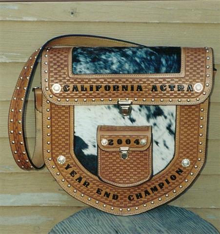

I have used gallons of Leathersheen/Supersheen over Sharpie dyed lettering and silhouettes. I have attached a few examples. These are not molly-coddled pieces. The toilet lids are exposed to steam and moisture a bunch. The rope bags and cans will see more lack of care than a pool cue case, and the Bible cover is probably handled daily. These have all been dyed with Sharpie markers, even the old turquoise and "antique" silver cross on the Bible cover are from Sharpie colors. The Sheen is applied with a sponge and wiped on. I am going to do the kiss of death now, and say that I have never had it smear. If you have access to sprayer, even better. I apply a few coats, this stuff will likely never see care again. I am a fan of the Sheens for personal stuff.
