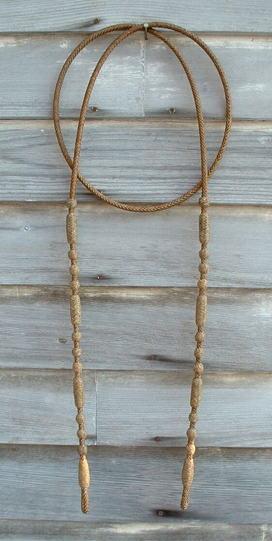

Just finished the knots this afternoon. Gotta get the romal braided and knoted up, then she's ready to ship.
These are the first rawhide romals that I've built with a leather heart, and I really like the feel so far. They have a really nice weight to them.

SWEET!
What do you generally use for a core? or do you generally make them without a core? I think I recall grant saying reins don't necessarily need a core.

I usually braid a rawhide core. That makes the reins a little lighter.

How many plaits for the core?
heck how many plaits for the reins...

Beautiful work!!
Now isn't the plaiting square or flat on anything over 6 plait if a core isn't used?

Nice looking work!! I cant wait to see the finished result!

I use round leather cord for core material - same as what Louis Ortega used in his...(I have some of his core material that was measured off for reins, romals, and graded on each small tag - written in Rose Ortega's handwriting)...!
Also, 12 plait on the reins, with a 16 plait on the romal, makes for a nice, useable set that is good for everyday as well as show - collector type sets will be braided with more, finer strands...i.e: 24 plait
I did 8 plait on the reins, the romal will be 12. I like using the leather cord, I'd like to find a place where I can buy sewing machine cord. I've been making my own round cord, so it would save time buying it.
On my braided cores, I just do a 4 strand braid.

Nice work as usual Rawhider.. look forward to seeing 'em finished

That's some nice work. Someone will be proud to get those.
I was curious as to what you have in mind to connect the reins to the bit. I don't notice any kind of latch.
THis particular style of rein is attached to the bit with chains. This gives the reins some weight which in turn makes the release of the reins quicker, so that the horse gets signal faster. They are to be used with spanish style spade bits.
