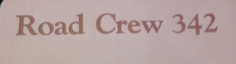

You want to type set it with printing type, then press it into the leather. It will be straight, clean and not tacky looking like it does if you use Tandy letters.
post-2349-0-35935100-1365224423_thumb.jp
