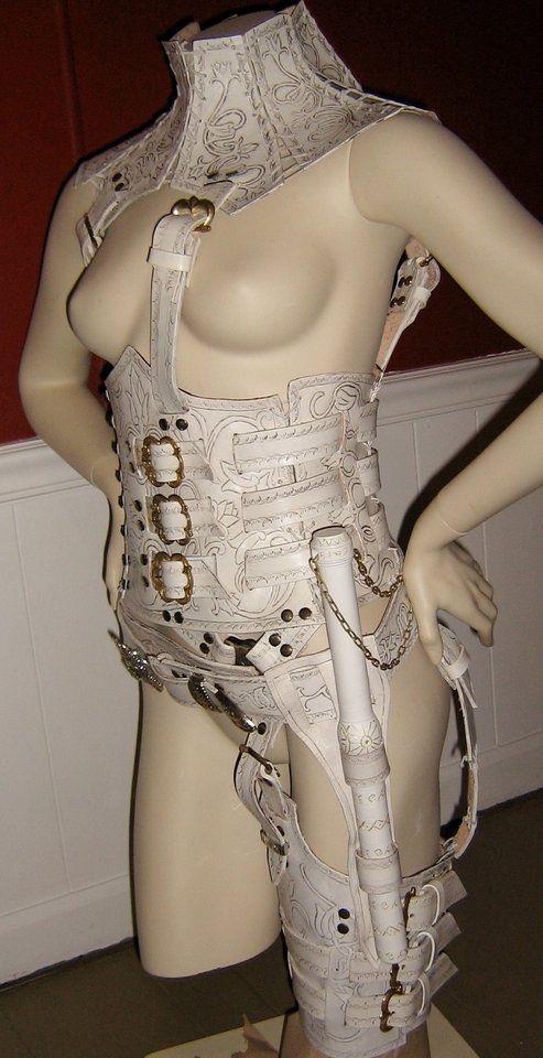

Unless the leather is already white you are pretty much out of luck. I had a horrible time coming up with white for this set of armor I did. I tried Fiebings leather dye which only came out mottled no matter how I did it and in the end I went with LOTS of Cova acrylic paint...which I definitely do not recommend for anything that is going to go through any amount of stress. After one time of wearing it the color was already starting to crack and peel. I have had much better luck with the Angelus leather paint, but even then I don't think it would hold up on a sole. God luck, and hopefully someone else has some better insight...
Silly picture didn't attached to my last post...
post-17044-0-16550800-1366656143_thumb.j
Awesome Morsith outfit Treybecca!
Thanks for the response Treybecca! Thats some nice looking work!
