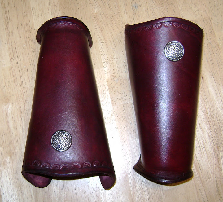

I make bracers and started with the Cowboy Cuff patterns from Tandy. I found if you measure your wrist like you mentioned and use a center line to transfer the sizes it makes it easier to make a pattern. Once I get those lines, I select the pattern from the cowboy cuffs I like and transfer to the top and bottom of my lines. You also need to measure the distance up and down the arm between your circumference measures. I don't use laces, I use a leather "bar" and snaps to fasten the cuffs. For laces, I would allow about an inch shy of the actual measurements to be able to get them tight enough. Experiment with construction paper before you start cutting leather. It will let you see where the problems will be on sizing. Here are a couple of my projects.

All good advice you're getting from RLW. Personally, I've given up on strapped bracers and will only make laced ones. The strap ones seem to always slide down no matter what. I do one lacing hole per inch, about a half-inch in from the edge. I also generally wet-mold the bracer and try to bend up the wrist area for comfort, like so:
I've found that lacing is best for heavy leather and hardened leather, but soft leather bracers generally do OK with buckle straps. Now, you don't have to reinforce the lacing holes with eyelets, but I tend to do so just because of the effect it gives. I figure the modern bracer isn't accurate anyway, so why worry about the authenticity of eyelets! ;)
