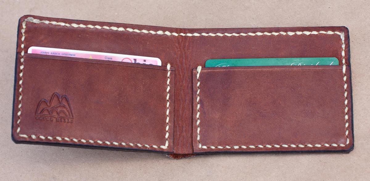

Here's some recent stuff I've completed.
First is another messenger black out of black Horween Essex. I used a different method to attach the straps. They are now removable as well. I also doubled up both straps and stitched them. Holy Good God it took forever. But it looks nice so....
Second is a minimalist wallet out of cognac Horween Essex. I made this for my good friend (his wife commissioned it for their 3rd anniversary). The divider in the middle provides two inner pockets for more cards (I stole the idea from Teranishi as his stuff is awesome).
Third is a square 3 pocket bi-fold out of toasted walnut Horween latigo. I stitched all around the wallet for the first time. I think it gives a nice finished look.
Fourth is a rounded 5 pocket bi-fold also out of toasted walnut. I really like this wallet design and think its an overall solid wallet. I did however switch up the stitching and used .030 maine thread in natural (which is more white than I expected) and stitched it at 6.5 sti.
Finally I decided to try a tooled trucker style wallet out of some Hermann Oak I recently bought off the forum. I lined the middle with some fabric. This is the first time I've lined a wallet. This is also the first time I have done any significant amount of tooling. The tooling sucks. I need to have way more patience. I tooled it while it was still too wet and then didn't wait long enough for it to dry before gluing the liner on. It was a good learning experience and I plan to experiment some more.
Thanks a lot for looking and I look forward to hearing what you think is good and what you think I could improve on!
Joe

I like the design of the last wallet and the second.
There is one thing I would change, the thread or SPi. The wallets would look good with 5 SPI with the thread your using or .58mm thread at the same SPI in the pics. The thread on your 4th pic is telling you that its too large for that SPI. 7 SPI is leaning towards thread in the .63mm at its "appropriate size". give or take .05mm
The 4th picture is the minimalist wallet with the J&M burned on? That is stitched at 5 sti with .040 Maine thread. Its the same size and sti as the messenger bag. All the items are stitched this way except for the 5 pocket bi-fold and the Trucker Wallet.
The 5 pocket bi-fold is stitched at 6.5 sti with .030 Maine Thread.
The trucker is 5 sti but I used 1.0mm Tejas thread from Tandy.
only thing that throws me off is the stitching on the forth picture with the white thread, brown wallet. The thread bulges out if its not pulled extra tight since its a little large. It could be the hole is too small or the thread is too small or not pulled tight enough. I find for me if I pull too hard you can visually see that the finish product that a ton of pressure was applied to pulling the thread.
The first wallet picture with on the right side stitching is what it should come out as on all the wallets, where the hole is larger.
I see what you are saying. The wallet in the fourth picture...the stitching along the top was through just one layer of leather so I had to go light on the tension to not wrinkle the edge. But to compensate I probably should of drove the chisel deeper through the leather to make a bigger hole.
The wallet you like the stitching on is stitched at a higher sti with a thinner thread.
Edited by Hi Im Joe
