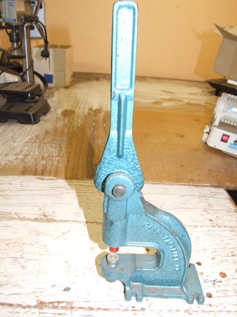

I've been using two Carr presses for many, many years and have never had a problem with them and they've set thousands of durables (line 24) for me. The handle goes either way. Just make sure you get good quality dies to go with them.
Tony.
Tony.
I have a Tandy that is about 4 years old and it has been really good. Weaver sells one that is good and both carry all kinds of dies for them. If you buy at a Tandy store, you don't have to pay shipping and they come on sale periodically. Ken
Tony.
Look familiar??
(feeBay Deal! $15 delivered)
