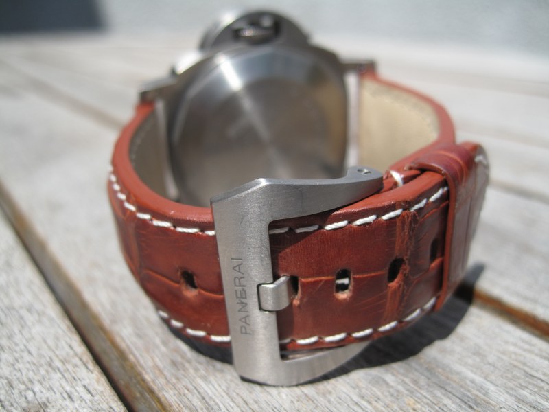

Still have to find a decent oval hole punch the right size and shape, does anyone have any recommendations 5mm x 3mm oblong with rounded edges not an oval per se? To punch holes like these.
post-32482-056562100 1340349386_thumb.jp
Then run the adjustable groover around the edges where the stitching will go. I guess it's time to case the straps after that. What's the consensus, middle out or edges in? I'd like to put a thin crease around the edges of the leather, should I do this before or after I use the edge beveller on them? I'm going to try outside in, bevel edges first, light rub down afterwards with sandpaper to smooth them then run the creaser around between the edge and the stitching groove. We'll see how that works out. Then the central design with the swivel knife and stamps(.... at this point it all gets vague, okay, the beginning of the preceding sentence is vague as well......) Then paint, dye and finish, glue the loops together, stitch the whole thing up and give it a polish. (.....Do you think anyone noticed?......)

I have made oval punches by pressing a round punch (try it on a belt punch not an arch punch) in the hydraulic press. Weaver Leather (over here in US) makes a series of them also.

Gah, how did I not think of that, will have to make do with a vice but it should work or even a hammer if I'm careful.
Blinding idea, thank you again.
