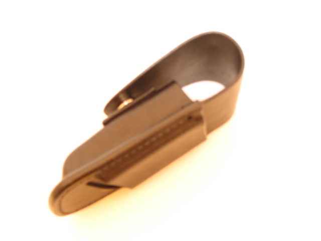

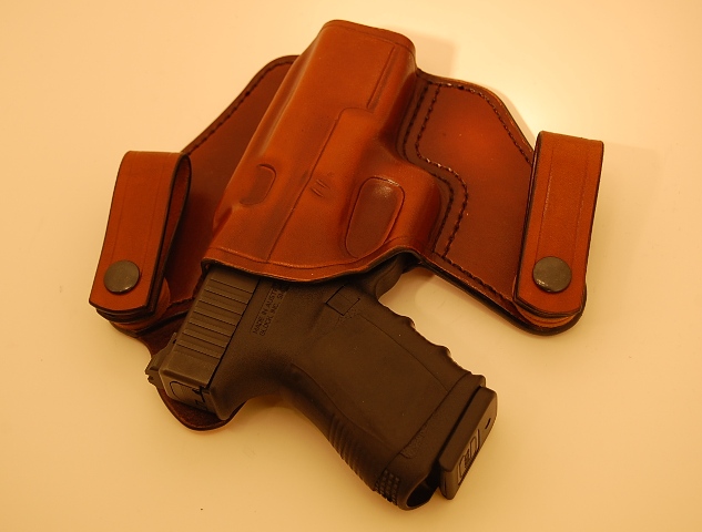

Believe it or not, the Glock 19 holster in the photo's below was glued up, and stitched on my Tippmann Boss before wet molding.
The mag pouch was built the old school way where the outer piece was molded first, allowed to dry, then stitched to the inner piece.
