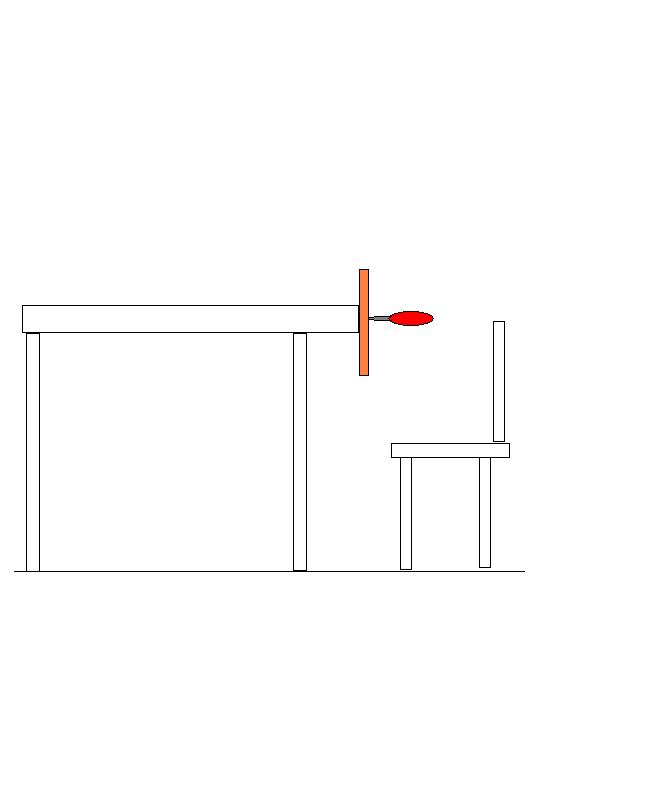

Some things I do differently, . . . but since most of my awl punching is done for small stuff, . . . I've gotten into the habit of using the edge of my work bench.
I've got a couple of small holes punched in there, . . . and I can lay that small piece up against the bench edge, . . . punch straight through, . . . and it is always 90 degrees and right on the money.
I actually don't do as good a job other ways, . . . this is my "preferred" position, . . . unless it is awful big.
