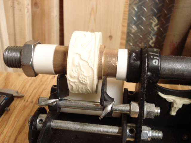

I purchased a Bunkhouse tools leather embosser about a year ago along with a few roll dies. Been very happy with the unit overall,great value and good results. Bunkhouse has a multitude of roll dies,some very unique.These dies are some sort of polyester,and come in various diameters,depending on the pattern.
Prior to buying the machine I was lucky to purchase about 6 Tandy Brass/Bronze rolls from an estate sale. I favored using the bronze dies as they fit the shaft tighter and I was able to keep the pattern centered quite easily.The poly dies seem to run out a little and keeping the pattern was hit and miss,

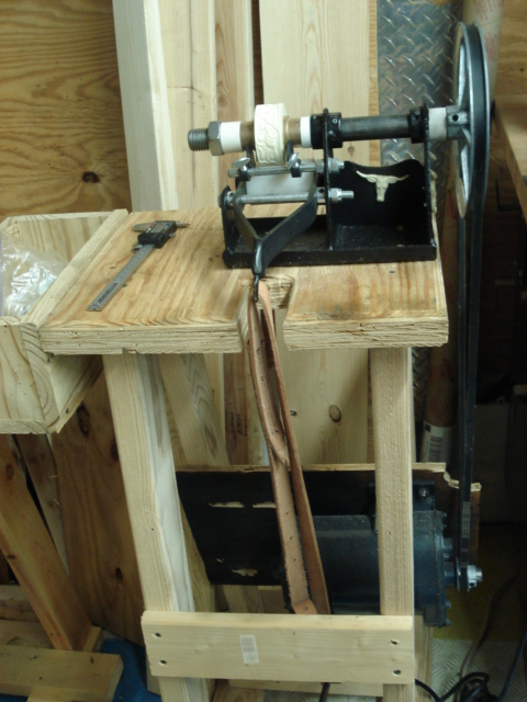

I added a 1/2hp 60rpm gear motor,with a 6 to 1 final drive (Final speed 10 RPM),and a foot switch. By having two hands to guide the piece I was able to get great results with the poly dies.
Recently I added a 1" flange Bronze bush to either side of the Bunkhouse dies,that alleviated all the wobble.Any body that has one of these might consider purchasing a couple of Flanged Bronze Bushings 1" ID x 1.25" OD x 3/4 L,or similar.
The Bushes are only used for the Bunkhouse Dies,the Brass/Bronze style dies don't need them. Now that the wobble is gone I intend to purchase additional dies from bunkhouse

The collars are fairly loose fitting,they probably work great with Bronze Dies as the Bronze Die ID's are machine with a couple of thou clearance. The Collars will retain the Bunkhouse dies,but they won't keep them true to the shaft.The Flange bushing only have a couple of thou clearance to the shaft so they will keep the rolls true to the shaft.
Thank you for the advice, I am going out looking for some this weekend.

This is the only example I have been able to find of someone putting a motor on to the Bunkhouse Tools embosser. Heck, I can only find 1 other example of someone doing it on one of the Tandy machines... but this is something I really want to do, so Frank, if you are around- I have a few questions!
1. can you provide any details as to the size/power/voltage/other specs of the motor you used, and perhaps how you set it up to attach to the machine (it looks like you have some sort of flywheel system)?
2. can you talk a little about using the brass wheels on the BT machine? I have some (and currently set up the Tandy one when I need to use those) because when I use them on the BT machine, they slip and/or chew up the leather (because I have to provide more pressure to make sure they dont slip). Any suggestions you can provide would be great because I would LOVE to operate just one machine.
Long time lurker, 1st post. Thank you all very much!
Skapa
The motor is a Von Weiss,V00212AV40 - VW40 115V AC Parallel Shaft - 30 RPM,12" pulley on the embosser,4" on the motor. Final RPM for embosser 10 RPM.Any 1/2 hp geared motor will do.
I purchased the motor off eBay ,they come available quite often,there is a Dayton replacement,don't know the model.
http://estore.vonweise.com/parallelouputshaftv00212av402z7941lpu5014q407-0056.aspx
I case the strips that I emboss. Not too wet,let the surface dry so the embosser has traction.
Hope this helps

the bushes you put on to hold wheel steady  dont they get in way of the guides that position leather ie if wheels 1” 1/4” wide and belts 1”1/2” wide
thx dave in uk
No Dave they are well clear of the guides.
