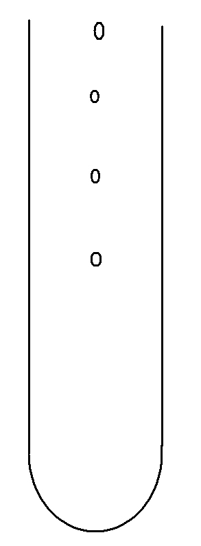

Well, . . . ya gotta promise not to throw something at me.
I use a mallet and an oblong punch, . . . or a round punch.
I first lay my template down and mark the back side of my holes on the top of the belt.
Then I lay the belt on a piece of scrap 7 oz leather, on top of my big marble slab, pick up my mallet, and "WHACK", . . . I've got a hole.
I start at the hole farthest away from the tip of the belt, . . . center my punch in the middle of the belt, . . . and seriously, I just whack it. Now my bench does not move, . . . it is solid, . . . and the marble slab makes sure there is no movement. And most of the time I am going through two layers of 7/8 oz leather that has been cemented together, sewn, dyed, and Resolened.
I use the cheap kit with screw on nose pieces for my punches, . . . I have both sizes that Tandy sells, . . .
Some people also wet their leather before punching, . . . I don't, . . . but you might try that.
