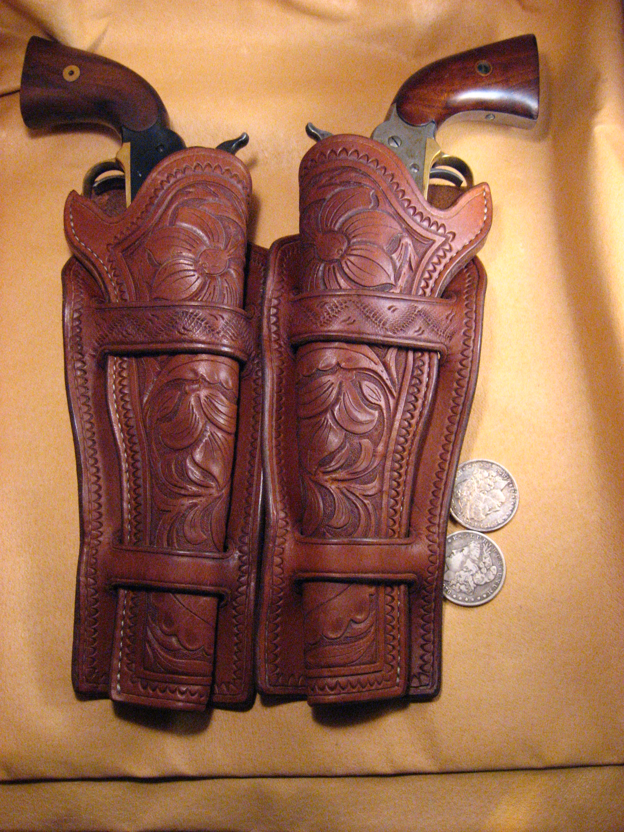

DaltonMasterson Report post Posted June 24, 2010 (edited) Howdy! I have used walnut dye with some success, and also use a coffee dye. For the coffee dye, I bring to a boil then simmer a whole can of dark roast coffee for a few hours, and reduce it. I get a nice mellow brown color after using a little bit of olive oil over the top. Here is a pic of a coffee dyed piece. It was submerged overnight in the dye, then oiled after drying. Then a little bit of sun, more oil, then back into the dye for about 20 minutes. The walnut dye is basically done the same way. Boil and reduce green walnuts for the best color. When I did it, it made a slightly more pale brown than the coffee, which is not so evident in the photos. The real difference in color is probably due to the sun and the oil more than the dye. DM Edited June 24, 2010 by DaltonMasterson Quote Share this post Link to post Share on other sites
