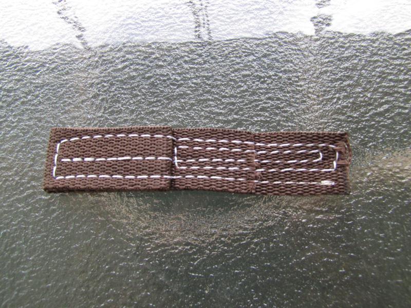

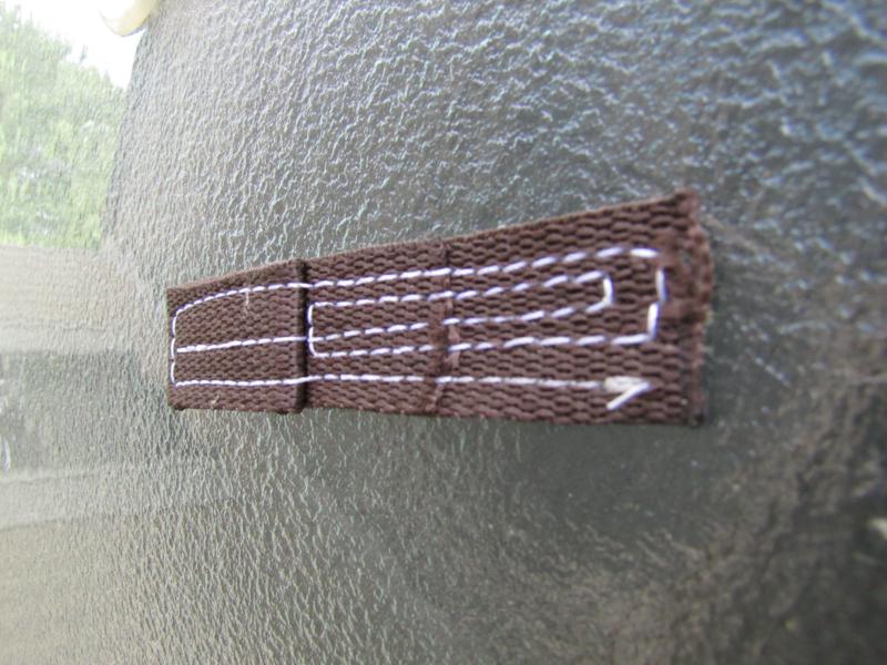

Here, as promised, are some photos of my CB4500 sewing webbing. One layer is about 1/20 inch. The needle is a #23 leather point. The thread is Cowboy #138 pre-lubricated bonded nylon.
post-11118-067680700 1338333941_thumb.jp post-11118-003012000 1338333950_thumb.jp post-11118-066447700 1338333956_thumb.jp post-11118-034414300 1338333961_thumb.jp post-11118-069791200 1338333968_thumb.jp
Thanks Wiz.
You have me sold on the Cowboy, for if you can sew a single layer of webbing that is about half the thickness of my webbing, then I don't see why I should have any problems with Cowboy...especially since I will pretty much always be using 2-4 layers of the stuff anyway.
Even though this means spending more money than I initially wanted to, it is good news as far as I am concerned because this means one machine should really be able to accomplish all my needs and desires for a sewing machine.
Lee
People used to tell me that these machines can't sew thin material, but I ignored them and did it anyway. I even shorten hems on jeans on my Cowboy. I have a table top attachment that helps keep flat work flat, rather than letting it fold over the arm. It's a very versatile machine once you get to know it.
