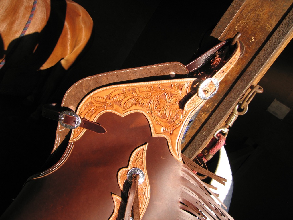

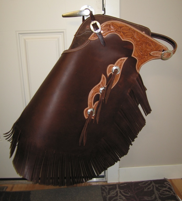

Hi folks,
First off, I wanted to thank MarkB for making such an amazing video on making chinks - it was invaluable for a newbie like myself in making sure I didn't make any critical errors. Thanks also to Chan Geer for the carving patterns, which I adapted from his belt pack and chaps trim pack.
This project was actually a bunch of firsts for me: first chinks, first sheridan carvings, first time hand sewing, and first time using my newly completed stitching horse. Lots of obvious places to improve, but overall, I'm quite happy for a first effort, and they seem to ride well (my horse was fascinated by the fringe).
The trickiest parts were bargrounding (by the end it started to look okay), getting an even stitch line on the backside (clamping was tricky in some spots), and working quickly enough on the carving side to not run out of moisture. The carving pattern on the belt was a bit of a bad choice - when rubbing the edges, I tended to roll them over the pattern a little since the border was only about a eighth of an inch wide.
Anyway, thoughts would be appreciated!
Cheers,
Adam

Next I will say that you did a great job on them. The tooling look well done for a first time. I really think you took the DVD and then put you ideas into your chinks. The hand sewing look well done.
I do see somethings I might work on but are not done badly at all.

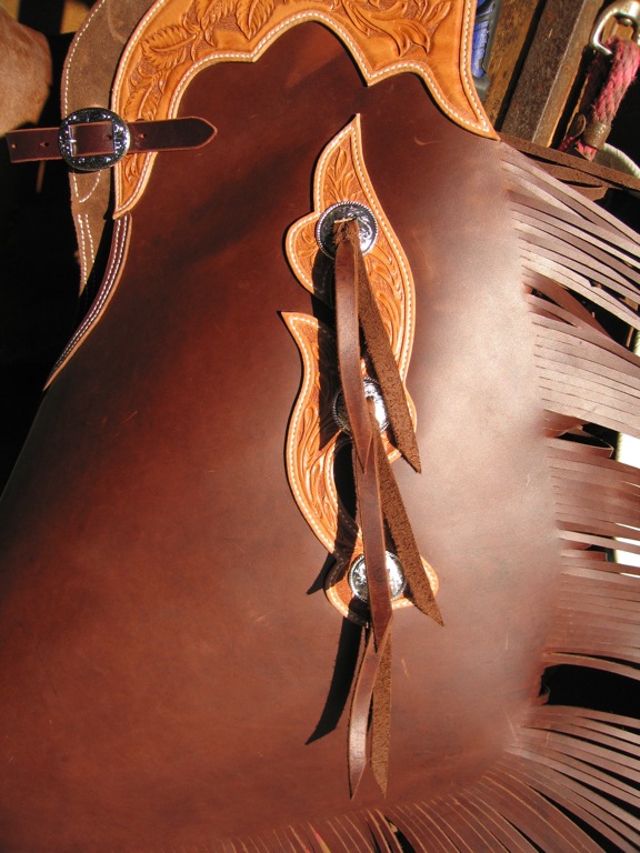

First is that I would start cutting the fringe at more of an angle so that as you go around the corner it will take less wedge cuts and it will also help the fringe to hang better down the side. In picture #4 you can see that a few more wedge cuts would have helped the fringe hang straighter sooner as well.
Next I would not have cut a border around the yoke just because I think it would look better where you did not back ground all the way out to it. IMO

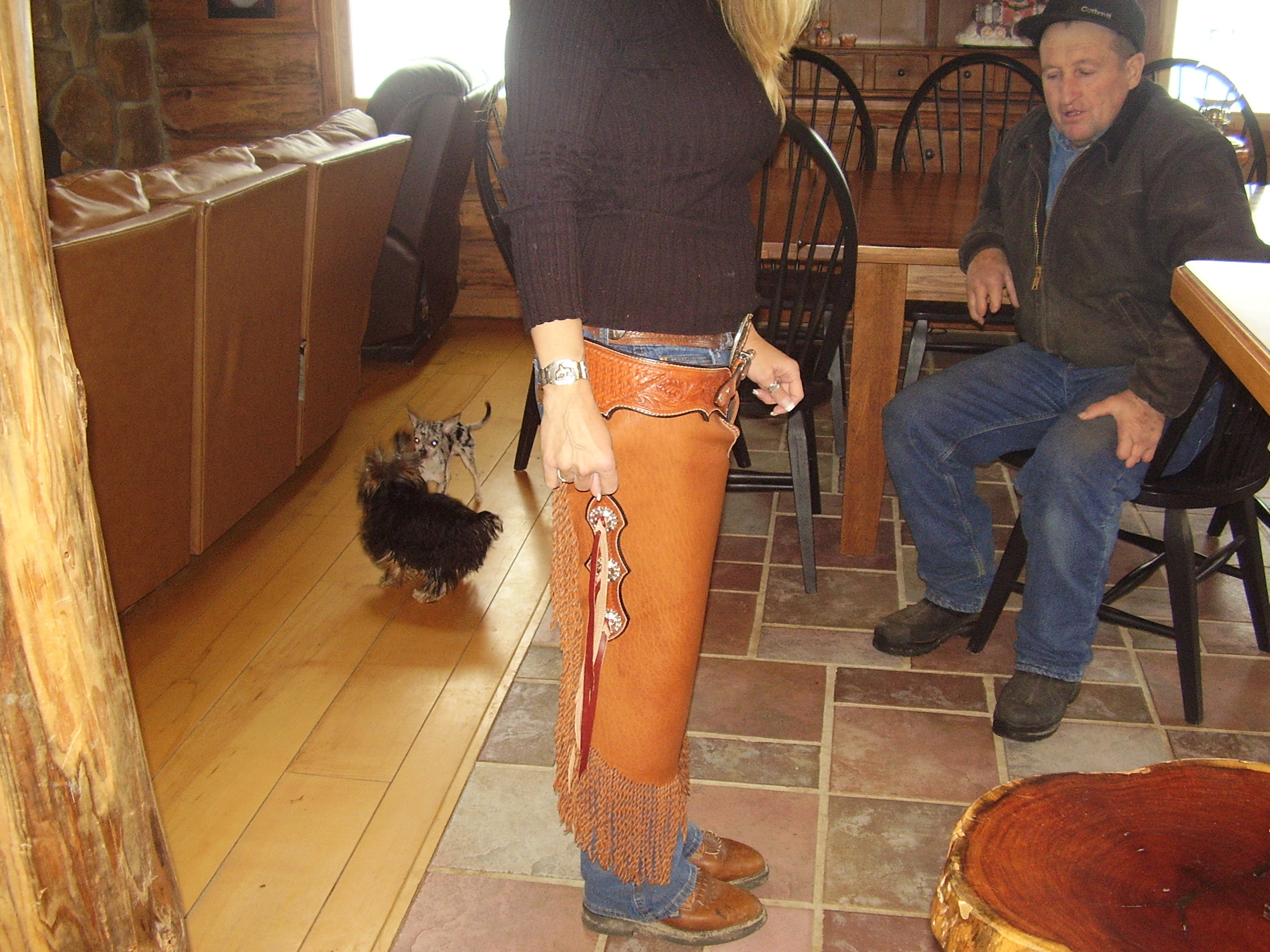

Just a couple of things. First, a really admirable job on your first chinks. Anyone would be glad to have and use them. That said, just a couple of comments, I echo Marks' commments on the fringe. Here are a couple of pics to show what he is talking about. One has twisted fringe, but ; they are cut the same way. Second, where the reinforcement is sewn on the top inside of the leg, I see that it stops just short of the yoke. I like to have it go up under the point of the yoke an inch or so. I skive it dorn to about 1/8 th thickness as the end so it does not create a bulge there, but it allows for much better strength at the point of the yoke and will be more durable.

>First is that I would start cutting the fringe at more of an angle so that as you go around the corner it will take less wedge cuts and it >will also help the fringe to hang better down the side.
Thanks again! I guesstimated at the angle based on what you'd shown on your pattern, but I could see pretty quickly once I was started that a steeper angle would have helped. That was compounded by the leather I chose, which isn't quite as compliant as some I've seen since (nice leather, just a bit too much body). Thinner fringe may have helped that.
I had already taken about 7-8, and was worried about losing too much leather. Probably would have been the proper decision though.

>Just a couple of things. First, a really admirable job on your first chinks. Anyone would be glad to have and use them. That said, just a >couple of comments, I echo Marks' commments on the fringe. Here are a couple of pics to show what he is talking about. One has twisted fringe, >but ; they are cut the same way. Second, where the reinforcement is sewn on the top inside of the leg, I see that it stops just short of the >yoke. I like to have it go up under the point of the yoke an inch or so. I skive it dorn to about 1/8 th thickness as the end so it does not >create a bulge there, but it allows for much better strength at the point of the yoke and will be more durable.

I definitely goofed on the reinforcement, and that became obvious after everything was together and I went back and reviewed Mark's DVD again. After next week I'll probably pop some stitches on the reinforcement strip and yoke and stitch a skived bridging piece in there...may as well fix it properly.
