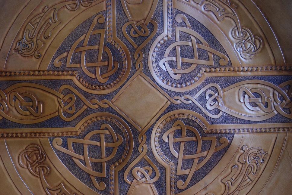

Hi,
I try to antique my tooled leather and cannot managed to get the result I see on all the picture in this forums.
I used lac kote from fiebings as sealer on my tooled project. I applied it with paint brush and also with a piece of an old teeshirt as I thought this will prevent the lac to get too much into the cuts.
Then I applied the antique past (sheridan and tan color). In both cases I ended up with only the cuts colored and all the parts that were sealed remained uncolored. I guess that the lac seal it preatty well.
I don't understand how you manage to get the antique past coloring sealed part? Do I miss something, do you guys antique or dye before applying the lac?
I bought the book "sheridan style carving" cause I thought that book would provide me more details, but It explained exactly the same process you are describing. But it does not work for me.
I would like to get the same result as I can see in the sheridan pictures exposed in this site.
Any help would be appreciate.

Hi Vince,
It sounds like you are doing everything right. I am not familiar with Lac Kote from Fiebings. I use use NeatLac. Maybe the Lac Kote won't accept the color very well I don't know. It does sound to me like you might be putting the lac Kote on a little heavy. Most of us use a piece of trimmed wool skin to apply out Neatlac and work it in rather thoroughly. I noticed that you didn't mention oiling your project before sealing it with the Lac Kote. I always oil lightly and let it absorb for a day before sealing. That provides a little color also. I like olive oil. Many use neatsfoot oil. Which ever you use be sure to apply it very lightly and evenly with trimmed wool skin. I use Fiebings Antique paste....it sounds like that's what you are using. I apply it heavily, insuring that it gets into all the cuts and crevices before wiping it off. Some of the colors do not color the leather very much. Tan is way too light for me and Sheridan Brown doesn't make much color either. In order for those colors to show you must eliminate the lac Kote and apply them directly to the leather. That works fine except it is very difficult to even coloring. The colors have a tendency to blotch due to the various surface textures in the leather. They will also highlight any marks or scratches on the leather, which aren't so prominent when you use a resist (Lac Kote)first. I use Light Brown quite a lot when I only want to highlight the cuts and depressions without making a big change in the color of the leather. If I want a little darker color I will use Mahogany. So I think that if you apply your Lac Kote with a trimmed wool skin and use a darker color you outcome will be better. I hope this helps...
Bobby

Hi Bobby,
First of all, thank you for your answer, reading your comments, the result I get start to make more sense to me.
Like you mentioned I used the antique past tan without any lac on my projectpost-19992-071971600 1310711804_thumb.jp
and again like you mentioned I ended up with marks ans scratches highlighted too :-( post-19992-087008500 1310711959_thumb.jp by the way I guess there is nothing I can do to remove it ?
In any case should I apply bag kote to it before I seal the project ?
Here is the last test I have made using Lac kote applied with teeshirt and sheridan antique, you are certainly right I have put too much lac, I'll try to get wool skin to apply lac and darker antique to see if I get better result.
post-19992-033280300 1310712167_thumb.jp
Regarding the lac, I did not managed to get NeatLac in Europe, this product does not ship to europe easilly cause it is flammable the only lac I managed to get was Lac Kote (http://www.abbeysadd...ail.cfm?id=L026).
I hope the result is only due to the amount of lac I use and does not come from the product itself.
Thanks, I guess I need more practise and test.
Vince
