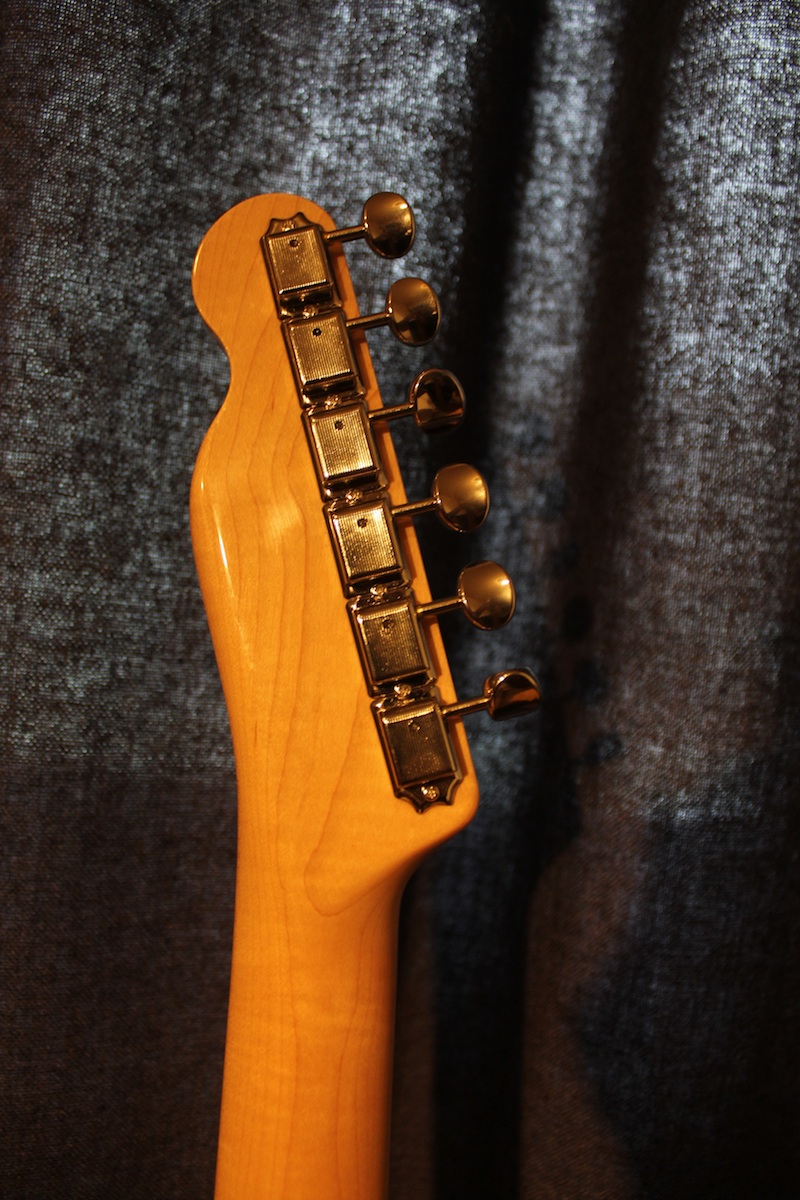

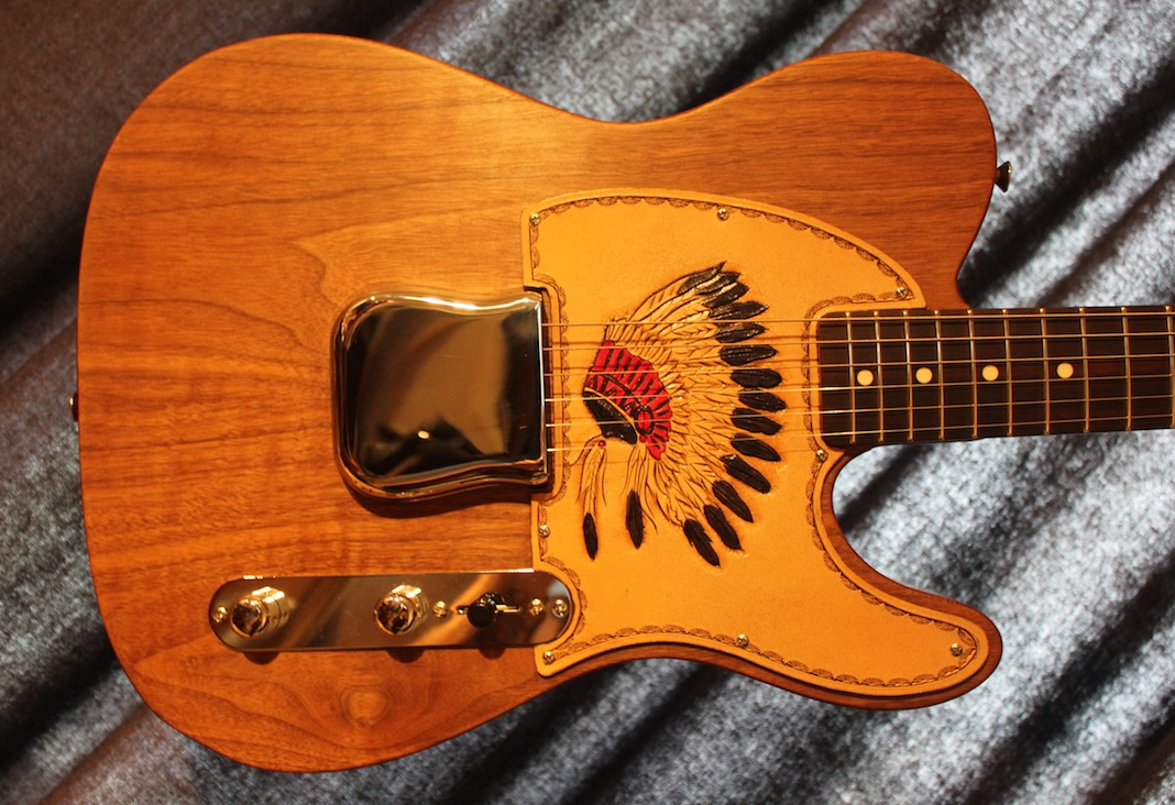

Well THE TRAIL BLAZER IS ALL DONEsmile.gif here it is before the studio shots and the custom strap that is in the works.
This guitar will be for sale with shipping world wide!
Golden Age Vintage Pickup
Compensated Saddles
Pull off fender ashtray
Gotoh Vintage tuners
9.5 neck radius with med jumbo frets (2 day re-shape and fret from the original 6 radius)
Bone Nut
10 coats of Danish Oil and Beeswax (2weeks of sanding and oiling)
Custom Leather Carved War Bonnet Pickguard by Chancey77 Custom Leather.
Comes also with a Chancey77 Custom leather strap.
Set up with 11's with a 53 low E
Ready to Rock!!!!!!
If someone is interested in and would like larger strings let me know we will set it up for 12 or 13's.
1400€ with hard shell case.
+shipping
post-28433-0-19107400-1352225309_thumb.j
post-28433-0-01416700-1352225315_thumb.j
post-28433-0-62394000-1352225321_thumb.j
post-28433-0-14151200-1352225335_thumb.j

great job!!!!!! Is the pick guard covered with some plexi glass. I really like the head dress. You done, did it, again!!!!!!!!
No there is no plexi...just a shot of Clear Laq.
I was thinking I was going to do a LOT more leather on this guitar but sometimes simple is just enough, especially with that beautiful piece of Walnut. I wish the PICS did it even slight justice! The danish oil really looks great and deep!
Scott brought back some Jewelers Punches from the USA last month and gave them to me so that is what I used to make the border.
