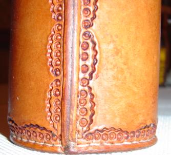

This is what the butt joint seam looks like on the bottle coolers I make.
post-19342-0-52225900-1361508861_thumb.j
Looks like I could do that on my machine..
That was hand stitched but you probably could use the machine then trim the excess off.
You might even be able to hammer the seam flat.
