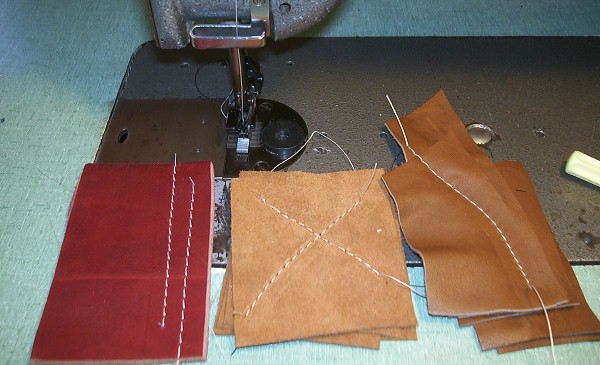

I have a 206 rb. That sucker is so strong, you can sew 8oz bridle leather with it. Can't speak for the price because I got an unheard of deal a few years back, but if you're looking for one of the best walking foot machines ever made (according to my machine repair guy) that's the one to get. I know that you won't be restricting yourself to rifle rests, you'll be wanting to learn all kinds of stuff, so you might as well get something that is versitile. Of course, it's not made for sewing heavy harness leather or anything like that, but I do just about everything else with it, from truck bed covers to putting zippers in jackets and chaps. And, I bet it will outlive me.
Here's a picture of stitches on a hunk of 9/11oz latigo, 4 thicknesses of 3/4oz suede and 6 thicknesses of 3oz chrome tanned (kind of stretching it)
Be careful sewing heavy leather or multiple heavy leathers with the medium duty/upholstery/canvas/sailmakers/trimmers machines. They will sew the heavy stuff; I have sewn up to about 23oz veg tan with the Artisan 618 SC-1 LTHR (LTHR means it has a speed reducer on it which is kind of important with heavy sewing). The place you have to be careful is when walking the machine uphill or downhill (changing thickness). When the machine walks uphill or downhill (downhill is when it usually happens) it can put a lot of sideways shear on the needle and a little 110 or 120 needle just won't take it. Not a biggie, but make sure you find ALL of the needle as pieces can end up in the shuttle race which can gall that up if left in there.
The 226RB was made in Japan and if still tight it will outlast you. Parts aren't terribly expensive either.
