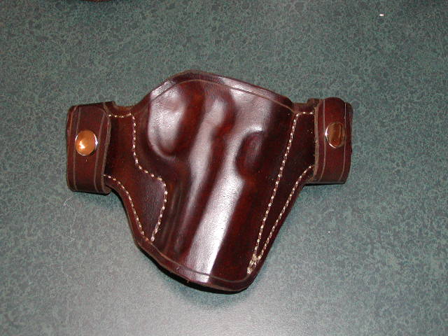

Yes, I work all of the flat surfaces using a round tool which I roll over each surface firmly. This compresses the leather and leaves a nice smooth surface. I do this on all holsters during the forming process, whether they are to be detail-boned or not. Most of my production is not detail-boned, but each one is fully fitted by hand. Detail-boning provides the best possible result, but a very good result can be had using nothing more than your hands and a few simple tools. This is why I offer detail-boning as an option for those who wish to have it, and are willing to pay for the additional time and effort required.
I am attaching a couple of photos showing the difference between my standard forming and a detail-boned piece. As will be obvious, I am not the master of this process as some others here are.
A mechanical press provides advantages for volume production, I am sure. But I have never used one and really don't feel the need
