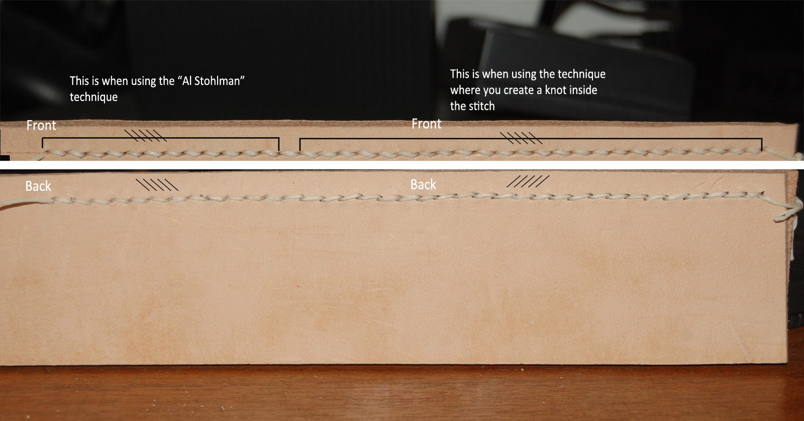

I'm just starting to sew leather and I have some questions:
Question 1:
When doing Saddle Stitching there are basically two techniques. The "al stohlman" and the one where a knot forms inside the stitch advocated by the user "jimsaddler". throw the back stitch
When using the "al stohlman" technique I get a nice uniform front and back where the stitches slope in the same direction.
When using the other technique the front is nice but the back slopes in the opposite direction. Se picture below
post-23717-040551300 1329599454_thumb.jp
In the thread jimsaddler says that it will
..give you the same slope, front and back
I just can't get the same slope front and back.
I do it like this: tutorial
Can anybody tell me how to get the sampe slope front and back?
I'm using a diamond shaped awl. The thread is18/5 prewaxed linen (s twist). The needles is no.4
I'm sewing with 6 stitches per inch.

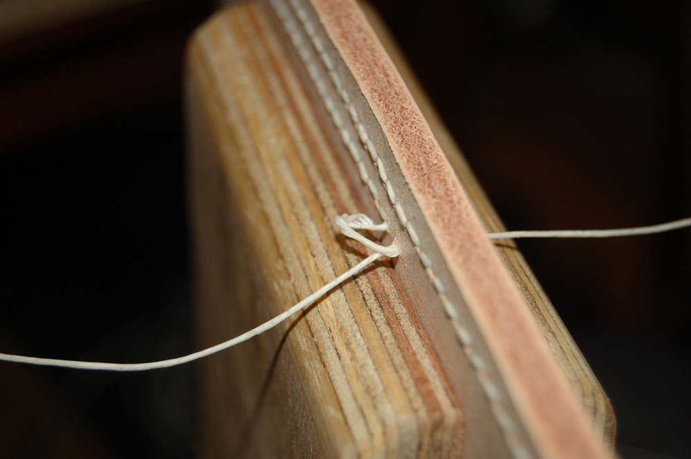

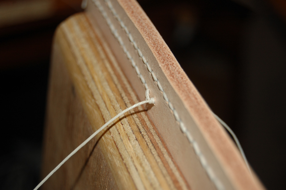

Question 2:
When I pull the thread through the hole it begins to unravel right next to the hole. It does this using both techniques
When I start to pull:
post-23717-074229400 1329600963_thumb.jp
"Al stohlman" technique
post-23717-084500500 1329600971_thumb.jp
"knot" technique
post-23717-091847000 1329600985_thumb.jp
is this normal?

Hi Jonabo
Basically you are using a left handed Z twist thread to sew right handed, so the thread is unravelling with both methods, Right Hand Sewing should be done with Right S twist thread. The comment about using the Braided Waxed Thread for hand sewing will overcome this. Also I think that you may be doubling the knot, as the back stitch should be pulled in as well the front. Which a single throw will allow to happen. Then the front stitch will have the same slope as the front ////// \\\\\\ remember the back is a mirror of the front as far as the Awl hole is positioned.from the top side.
"knot" technique
is this normal?
Hi Jonabo

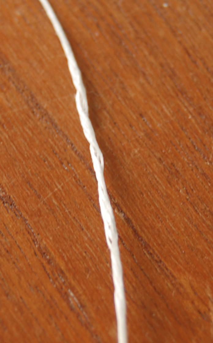

Hey jim thanks for the reply
I was under the impression that i was in fact using Right S twist thread.
This is the diffrence in s and z twisted thread right:?
This is my thread:
post-23717-023874100 1329660802_thumb.jp
According to this I would say that my thread is s twisted?
I could off course try to get a thread twisted in the opposite direction to see what happens. Unfortunately thread is for some reason hard to come by in my country so it could be a challenge. It is for example more or less impossible to get 18/5 unwaxed linen thread.

I think i figured it out.
When I put in the needle on my right hand side I usually put it on top of the thread that i already pulled through the hole. If I instead put it UNDER the thread already in the hole, and then throw the thread under and then over I get the stitches I want.

I was about to say the same thing. Your needle placement looks like it had been switched. You have to use the same exact pattern while stitching or your stitches look like that.
You've got it figured right in the second video. You throw the thread up and over the needle (away from you). Practice makes perfect, you have to get comfortable with the Awl and Needles to the stage you are not able to stitch without them in your hands.
As far as the Thread twist the S twist is right to use, the throw in the first video was causing the unravel it appears.
