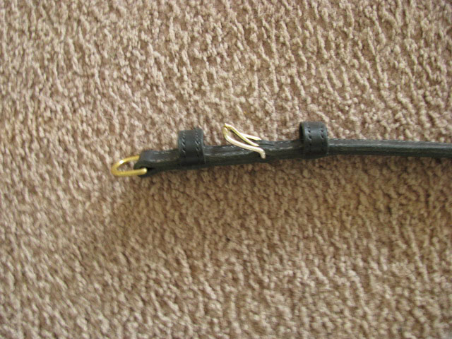

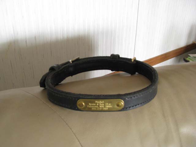

Rather than use two straps, I've 'folded' one long one in the center, where I but a D-ring. An inch from that I added a keeper. Another couple of inches, on goes the buckle. Then a couple of inches another keeper. I've handstitched all the way around.
One I did for a customer had a brass nameplate and I just riveted it to the top piece before sewing - you might want to do that with the bling before you sew it up.
The collars I'm making are 1" veg-tanned straps from Wicket & Craig. Doubled like they are, I plan to use them for tracking and I plan to make wider ones as 'agitation' collars for protection training.
I plan to make one up incorporating a 6" handle strap. I'll rivet that to the top layer also.
Here's a couple of pics - taken before the edges were finished. I know, should've done that first. Still learning. :whistle:

If you could show me one of yours layed flat out, I'd appreciate it. I was thinking the buckle went on the end, but I re-read your description and realize the D ring is on the end.
Here ya go. You can be flexible with the keepers. You can eliminate the one between the D-ring and the buckle and once you get the buckle sewn on you can place the last keeper when the buckle tongue is in the middle hole. I've got the holes spaced about an inch apart so I've got room to adjust. If I remember right, you're measuring total length of the collar.
I measure where I plan to have the collar ride and put the tape around the neck snuggly (not tight). Adding an inch or two is not necessary.
For example: On a 19" neck, from the fold in the leather to the middle tongue hole will be 24.5" and overall length can be 30" (I leave that determination until the end)
Once I've sewn the hardware in I put the two pieces together with rubber cement and feed it through the D-ring until the inside measurement (circumference) is the same as that of the dog's neck. (from the D-ring, around to the D-ring again. Then you can mark where your center tongue hole will go (where the tongue rests atop the buckle) and punch 2 holes on either side of that hole.
Hope that's clear.
