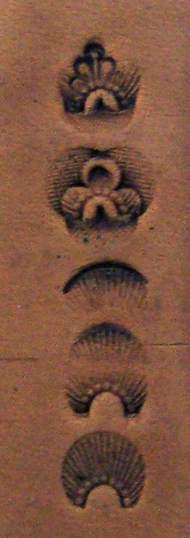

Choice bro ! ( Kiwi expression) Now we're getting somewhere . Sounds good what you're suggesting although how would we go with different parts of an individual stamp , for example an N720 craftool . i dont think i have ever used that stamp as a full image , i use top or bottom (see sample)leather_plaque_038a.jpg . The question is can an individual stamp be made to imprint more on one edge than the other , deeper etc . i dont know if the 2D image would work as well as in 3D . Whadaya reckon ? also there are images of stamps in online stamp catalogues although scale could be another problem as all of my tools fit together in ways that I know , any small variation in size would alter the fit of certain tools and make some combos that i'm used to now impossible to recreate , or have i got it all completly wrong , after all i did just wake up ! Thanks UK Ray you're a #&$%# Legend . Cheers Dave ! PS excuse the rough stamping , Did it quick in dim light !

As far as showing only half a stamp.....well, you have to make the impression on some leather before you scan it....so I'd say make a scan of 5 impressions of each stamp (that's starting to sound like work isn't it). Full impression, then top, bottom, left, and right. Either that, or when you add the image in the layer, just use the eraser tool in the graphics prog. to remove what you won't be using.....naw, that's too simple. Do it the first way to have the image of what you'd put on leather.
