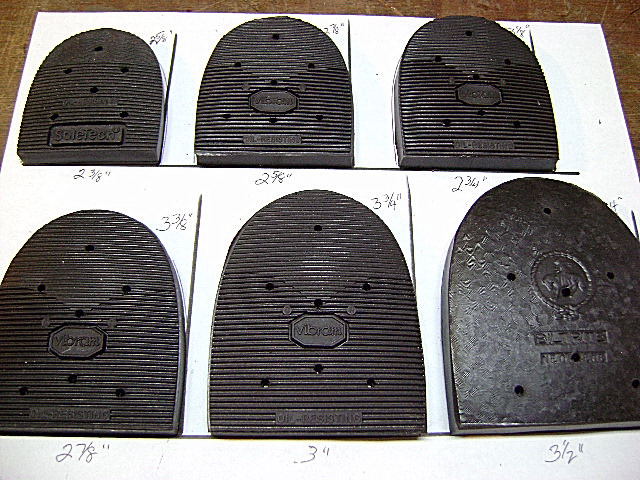

Attached please find a chart I put together for you, outlining several CB heels, in an attempt to answer your sizing question.
Some of the figures may be hard to read. Let me know if you need any clarification.
CB heels are solid rubber with washers to cinch the heads of the nails (known as Rubber Heel Nails ) tightly to the heel base.

The heels used for this photo were what I could grab quickly. Different brands will have slightly different measures.
Oops, I just saw that I didn't label the sizes.
Across the top are 5, 7, and 9.
The bottom row are 11, 13, and 15.
