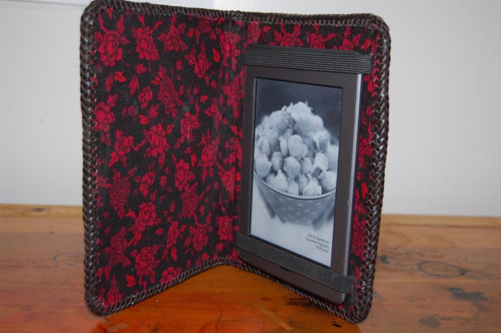

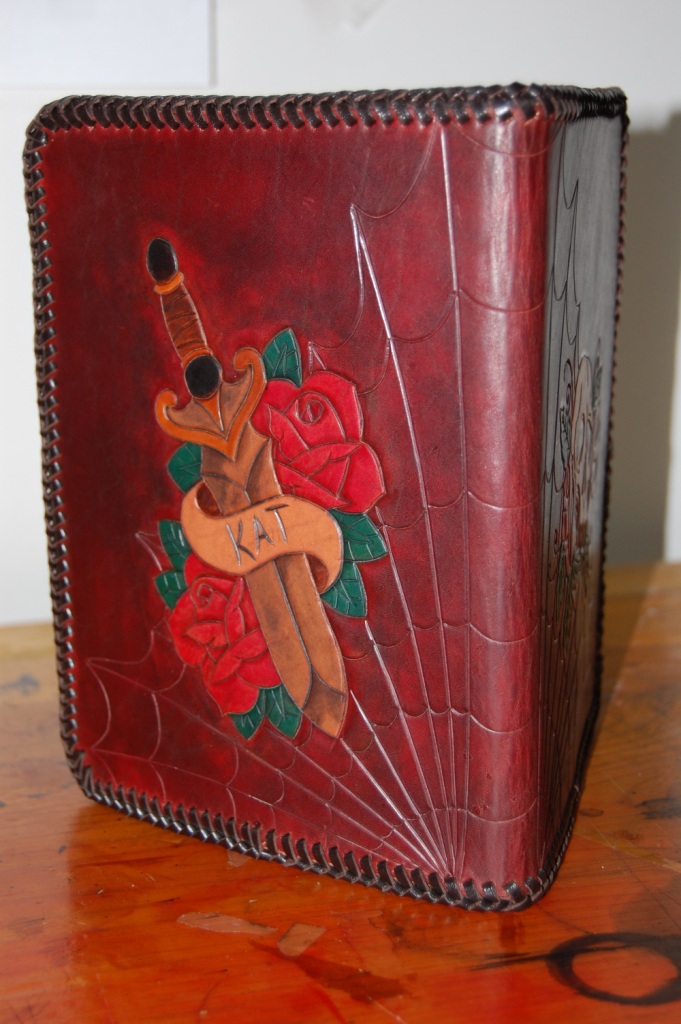

I was finally able to get my wife's kindle cover finished up since I'm on vacation.
Did the whole thing out of some 8-9 oz (scrap piece from Zack White) and then ended up putting a lightweight calf-skin liner in it to hold the elastic bands since the linen was only going to tear out. She opted not to have a closure system since it will pretty much always be in a bag of some sort.
Really need to work on keeping even tension on my lacing, but the important person likes it (or at least she's just happy I'm done with it).

That looks really good, glad to see the leather has kept
that natural spider web pattern it had.

So here's how I attached the Kindle to it. There are probably better ways, but it's what I came up with and it works.

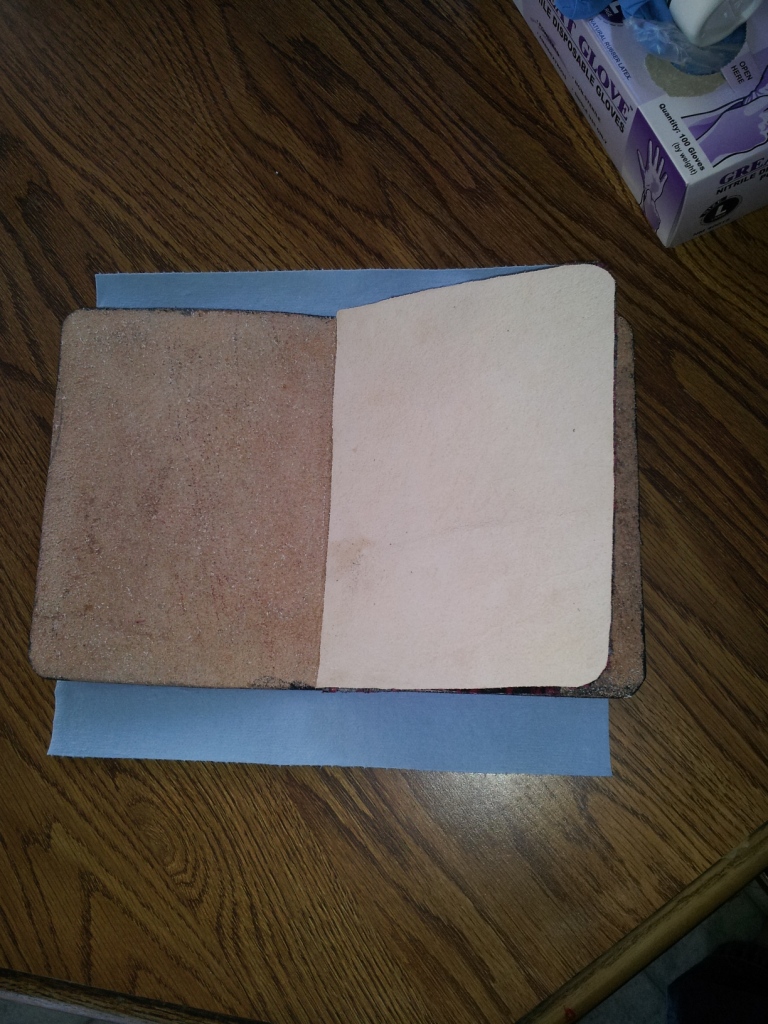

Here is the left side liner ready to glue down. Nothing to fancy here.
post-22094-007258400 1334948167_thumb.jp

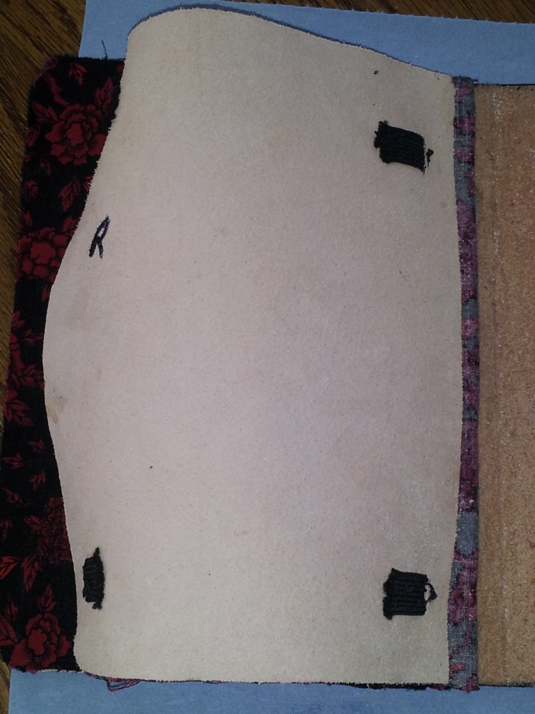

Here's the tricky side. You see I've marked which side it is (confusion is annoying). The straps are folded from the outside facing in toward the center and I've stitched all around the edge, as well as on the outside edge of the slits. You can also see the unlined portion of the binding. Keep in mind, the lining is only here to hold the elastic.
post-22094-001503000 1334948215_thumb.jp

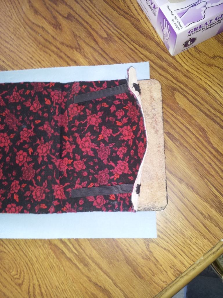

Here you can see the first half of the right side glued down. At this point I know everything is pretty well lined up so I can focus more attention towards keeping the elastic stretched out while gluing.
post-22094-047391300 1334948341_thumb.jp
