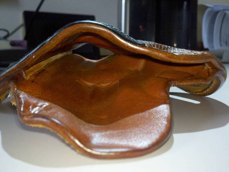

I've decided to only use it as an inlay due to the edge issues.
My latest set:
I had pretty good luck skiving the edges very thin before gluing and then I just edged and burnished like I normally do. Came out fine.....
My latest set:
Pretty work Shooter!
Thanks for the insight folks. Shooter, I am rethinking my process now and am probably going to go the same route as you. Doing an inlay and having a window around the Caiman would solve edge issues and make life simpler, just a little more leather and sewing.

When I have worked with fiberous leathers as overlays I soak the edge with acrylic resoleen to "glue" the fibers together and then sand with 600 grit until nice and smooth. That is how I do edges with fresh water shark and how the attached edges for some really soft Alligator were acomplished:
post-10631-024653400 1318966211_thumb.jp
I've had good luck sanding off all of the fiberous material off of the back with a sanding drum in my drill press, detailing the edges with a dremel. For an overlay I then gle it to 4/5 oz and put the freshly glued piece in my press between 2 pieces of gum rubber for a good long while.
That inlay looks very nice.
