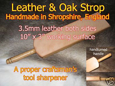

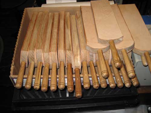

This week I have made a batch of strops. Mine are pretty simple double sided 3.5mm leather on oak with a little turned oak handle. I sell them on eBay but, given their essential nature, I keep thinking I ought to be selling more of them. Maybe I haven't got the design right? Maybe they need something else to make them more attractive - I believe they work just fine.
What sort of strop do you guys favor? Can you share a picture please? Any hints or tips as to size and materials?
What about jeweller's rouge? Grinding paste? What do you use? Should I supply this with the strop or sell it separately?
Any help or suggestions gratefully received.
Ray

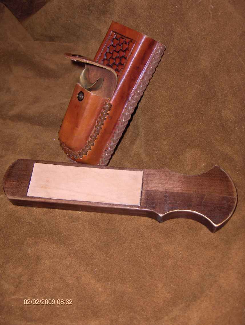

Well, this just gives me a chance to show off the strop and case jbird made for me during the last PIF. Pretty dang neat, I thought.

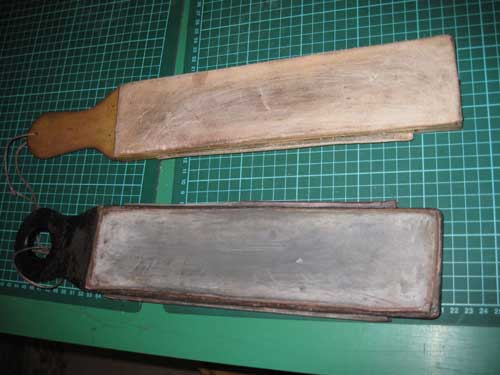

At this point I have to 'fess up and show you the rather disreputable pair of strops that live on my own bench... I can't justify a new one until I wear these out!

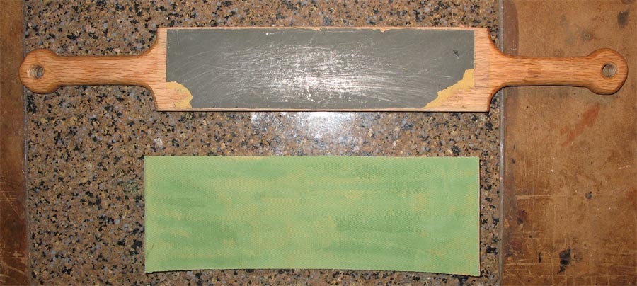

Here are two of mine. The green one is one I just bought from Bob Beard that is a conveyor belt I believe loaded with green rouge. The other one has two handles so I can use either hand and turn it either way. It has 1000 grit sandpaper on one side (needs to be replaced) and matting board on the other with green rouge (over the red I had on it before and removed). The Beard strop I use for my swivel knives.
Art
