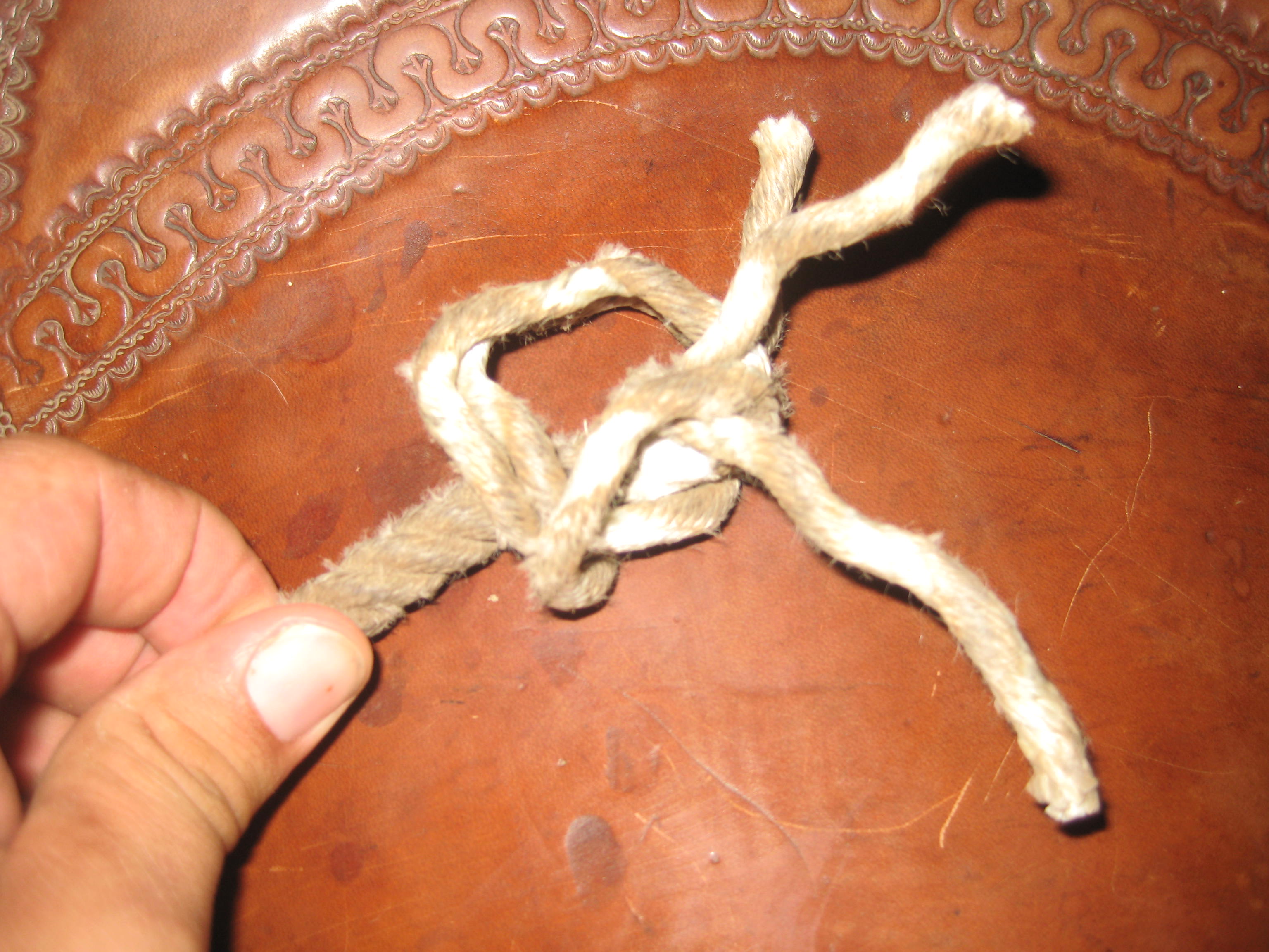

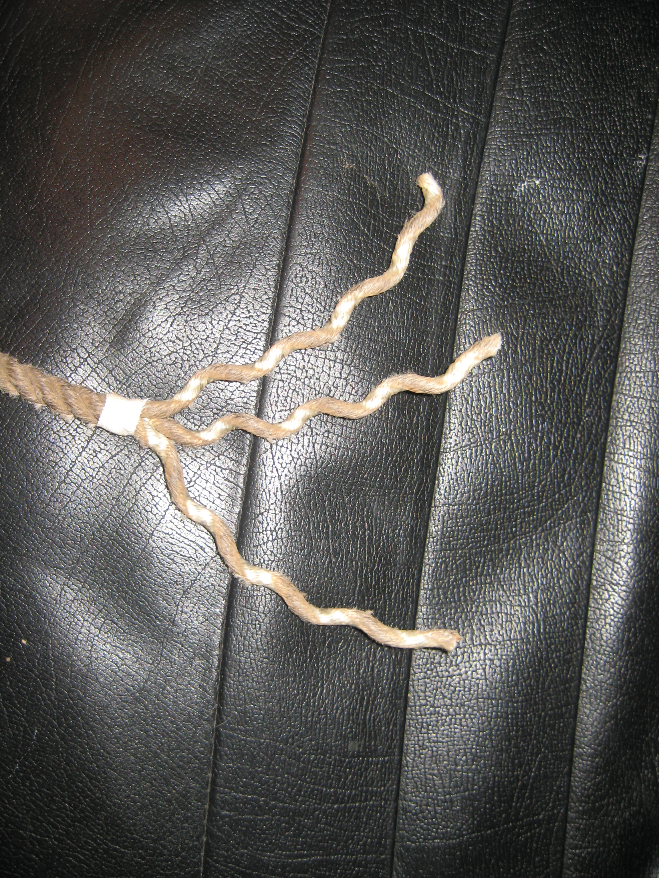

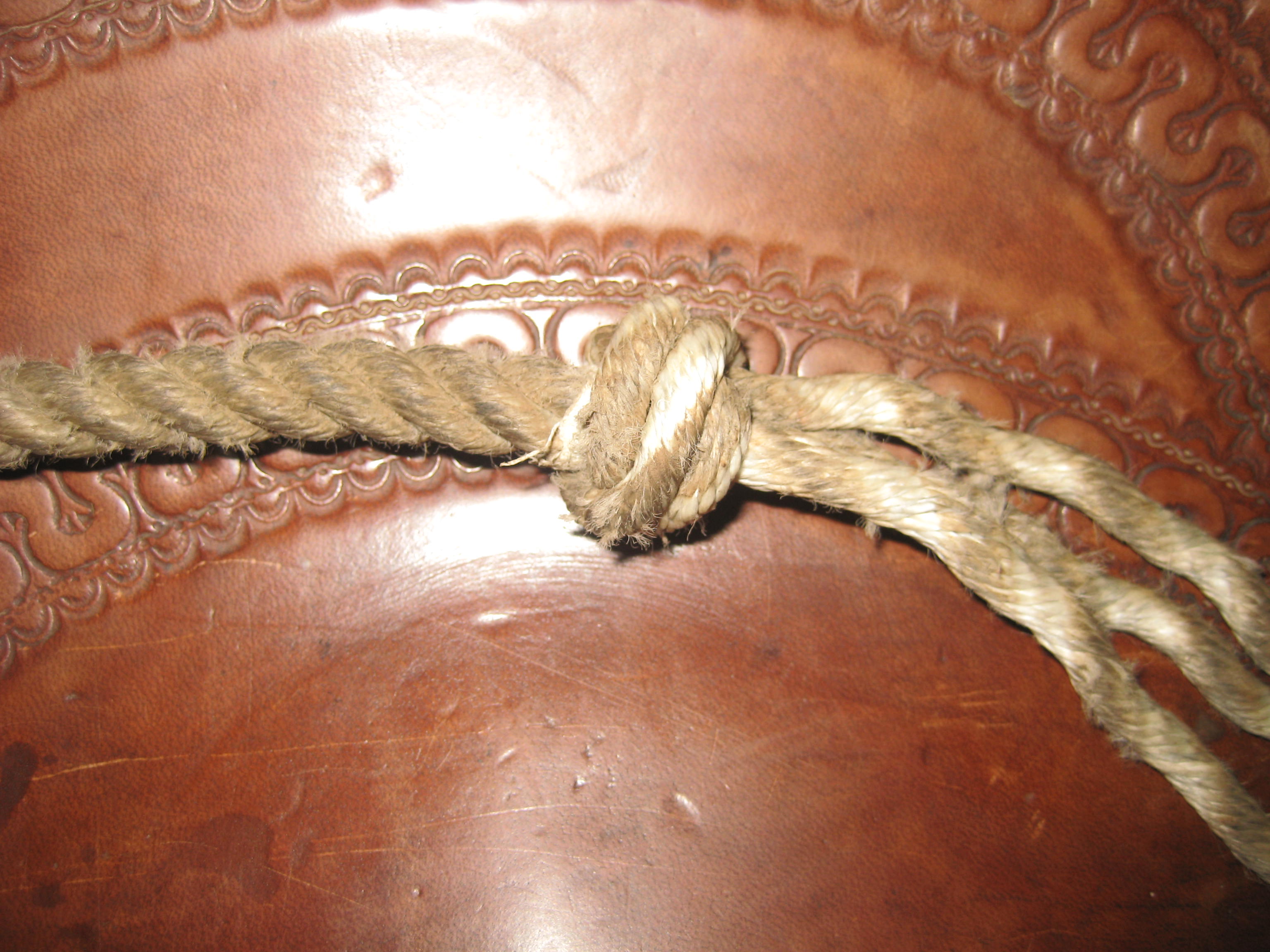

I didn't look at the links so if this has been covered just ignore it. I think this is one of the knots Bruce was talking about.
Here goes first tape the rope back a good 6 to 8 inches. Next untwist the rope to the tape.Then grab a strand and wrap it around the rope and run it back thru its self. Then grab the next strand above the one you just tied and wrap it around the rope and thru its self. And do the same with the third strand. Then you will grab one it doesn't matter which one and pull it snug. And then pull the other two snug one at a time. Once you have them all snug and laying right ya can then pull the fire out of them one at a time to really tighten them down. It works really good to use a rein rounder and a pair of lasting pliers(I think thats what their called) to get them really tight. I just hand tightened the one in the picture. This knot will not come untied once tightened. I hope this helps and I apologize for the rough tut. as I am not to good at explaining things.
Mike
more pics
Mike
I think they just call that Back Splicing. Us common folks just call it a "Dog's D--K" !!
Tony.
more pics
The last one I promise
Sorry for the big pics. But the wife isn't home to resize them for me.
Mike

I don't know if it is correct, but my grandfather taught me that knot when I was a kid, and he always called it a rosebud. I like it better than the turk's head type on rope ends- it covers the twist of the rope better and the rope holds it's stiffness right up to the knot. Anyone else heard it called that? Those pics show the sequence very well- I haven't tied one in a while, and may need to refer back to those as a reminder-
Chuck

thanks that is the knot I am looking for.
