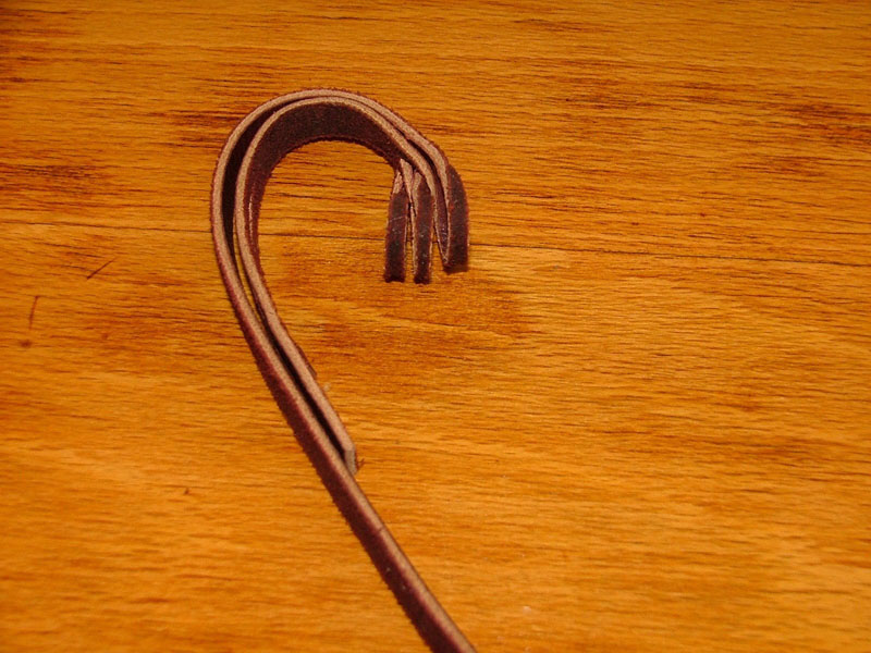

I don't know what you call it but here are some pictures of one taken apart and then going back together slowly.
Dan
That's it Dan. I think in the book they called it a Kimbelry Knot i'm not sure what it's here in the states.

That's called a slit braid. The strap is folded over the clip or made into a loop for the handle. then the straps are slit in increments front and back in a stair step pattern.( ie. three slits, less than the strap width, on the front side and two slits on the back side, between the ones in front or as many slits as wanted but always one more on the front side) Then you pass the back strap through the top front slit and the front (which is now the back) through the next slit and the next and the next etc. Always working the back through the front.
