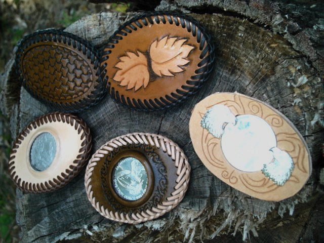

Sorry for the late reply here. I missed it. Below I posed an example of what I did. you can find individual punches the size you need, but unless you do a lot of punching, it's probably not worth the 30/40 bucks for one. Just use a sharp xacto knife or the like to cut out the hole, use a french edger to recess the back side of the hole and burnish the inside of the hole. place your coin in and cover it with a liner leather. A liner is just a piece of leather to cover the back side, they are either glued down or glued and sewn.
Marlon

Sorry for the late reply here. I missed it. Below I posed an example of what I did. you can find individual punches the size you need, but unless you do a lot of punching, it's probably not worth the 30/40 bucks for one. Just use a sharp xacto knife or the like to cut out the hole, use a french edger to recess the back side of the hole and burnish the inside of the hole. place your coin in and cover it with a liner leather. A liner is just a piece of leather to cover the back side, they are either glued down or glued and sewn.Marlon
Marlon,Thanks for the reply. That seems to be getting there. I have made the copper fittings punches for the OD and ID of the 50 cent piece. I'll have to research a french edger and burnishing. I'm only familiar with burnishing in relation to printmaking.thanks again this gives me something to work with.Lee
