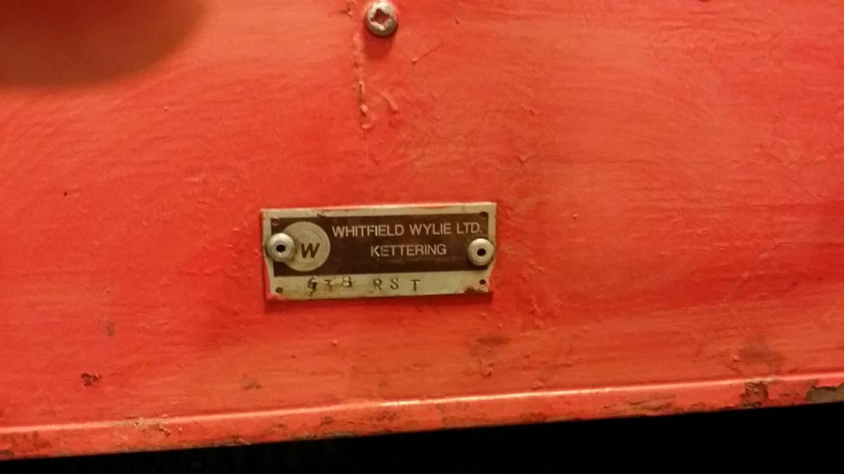

Is it somebody in this forum who knows these ovens. I got an old Whitfield and Wylie flash activator from a shoe repair shop I sold for a friend. This was a leftover from the sale and I thought about using it in my leather shop. I cleaned it up and checked the wirings before I tested it. I turned it on and the infrared bulb was working, then I pushed the boost button and a terrible sound started. The boost was set for 12 seconds and the sound lasted these 12 seconds as well. It produced heat as I suppose it should do. I never tried a "machine" like this before, and it sounded like a very loud microwave. Perhaps it is a kind of microwave for all I know. Are they supposed to sound like this, or is something very wrong with it? It has a fuse inside and nothing happened to the buildings fuses. Somebody with knowledge about these please give me some help here.

The oven has no fan. I took off the back plate and cleaned out all dust/dirt before starting it the first time. It had a timer inside set to 12 second, a 3 position switch, a infrared light tube and a fuse. I could not see the heat elements because they where protected with a plate and placed inside the ovens ceiling. There where no other visible components, only good organized wiring inside it. It looked pretty straight forward.
Electrathon, I know what a transformer hum sounds like,but this sound is what I will call horrible. I looked true the wiring inside, it was very well organized and looked like it was made for high current. In fact I have never seen any such electrical component better organized than this. It was built by someone that was very concerned about safety, thats for sure. That is why I wondered it perhaps should make some noise during its boost period. Not as much as this one, thought its an old "machine".
I would have asked the previous ovner if I could, but I do not know his whereabouts for the time being. I had never heard the term "flash activator" either, before I started searching about it on the Internet. I suspect it is a British term. It makes perfectly sense when you think of its use; to activate the glue on shoe soles. When you turn it on the red light tube produce a bit of heat, then you set it to the 12 seconds boost mode and the heat is intense.
http://www.standardgroup.co.uk/ http://www.standardgroup.co.uk/shoe-repair-ancillary-items The Withfield and Wylie LTD Company Kettering UK who made this and many other shoe machines, is now a part of the Standard group. They make similar ovens today and you can see the timer is placed outside on the front panel on them. Perhaps there are some shoemakers/cobblers out there that use these that know how these are suppose to sound like. I just want to know if it worth using more time on, before I start searching for any errors on it. I can always send an email to the Standard group and ask them if its a well known problem or not. But I am afraid they just will tell me to send it in for refurbishing or buy a new one.

post-10237-0-78024100-1431119776_thumb.j
post-10237-0-83758100-1431119820_thumb.j
