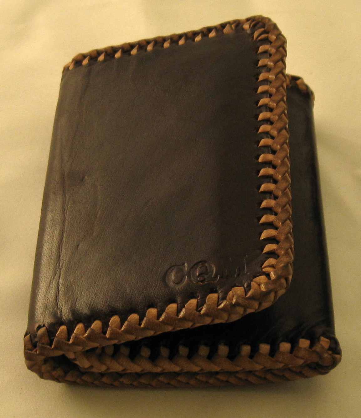

Give it a shot, worst that could happen is it doesnt work out. Heck I made three wallets before I came up with this one that I am happy with. I wish I had money for all that extra leather as well lol.
I didnt get any pictures of the one I made with the tooling but heres mine, its just a simple one.
Nice wallet MADMAX22. I'm definately gonna look for pig on the next one. Got my vinagroon out and I'm jumping in.
