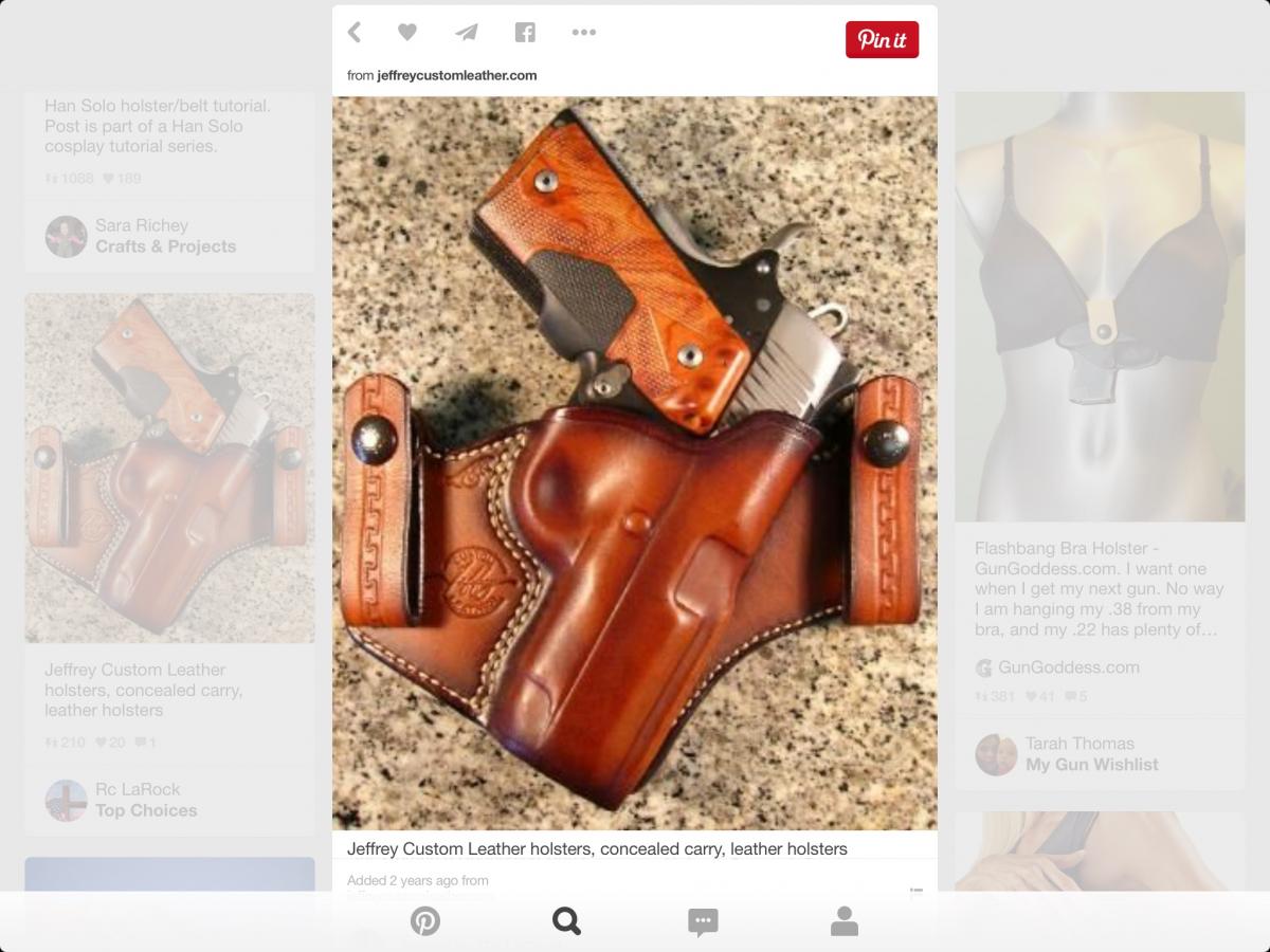

This is what I want to make
Something like this for my first one I realize there is some wet molding involved which I have no expierience with but
I watched a really informative video with Sam Andrews and Hank Strange on holster building it was on You tube
On the outside of the belt or owb

Ps camano ridge the 6 shooter link with Jim is awesome!
I'm going to print that out at work today and make it I to a book !
You have received some good points, if you watched the sam andrews video. One of the very few videos in an ocean of u-tube dross that is actually worth seeing.
