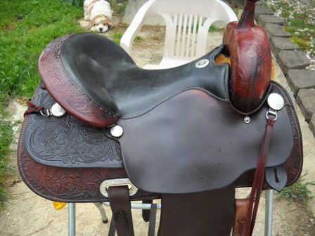

I will see if I can find out what they use for oil. I would love to have a few choice words with the leather shop but I am limited to what I can say cause I have a family member working there and really don't want to have any family problems right now. At this point I feel it better to just see if I can darken the spots that are the origional color and sell it. It may be less expensive to do it that way cause right now with all the ruined jeans and saddle blankets that are getting all full of oil it's starting to feel like it's not worth it. When you tough the saddle your hands have this greasy oily feeling and my jeans are all blotchy with dye and oil that is coming from the saddle. I am going to attach a pic of what the saddle looks like right now. Most people tell me it's not that bad....
Thats a bummer, looks like a nice saddle minus the oil. What did they use a barrel to dunk it in.
