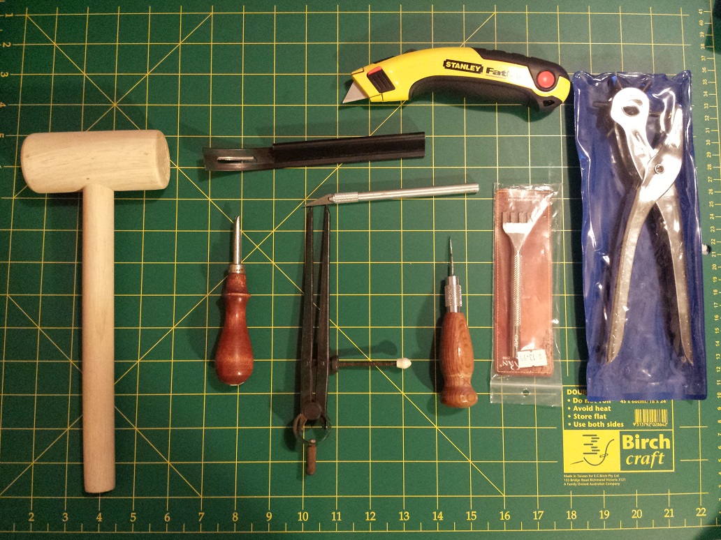

Plz have a look at the tools I proudly own at the moment.
Thx.. and your comments please.

Guys what do you think of the tools I have bought? Are they ok? ..any comments on the quality (as much as you can see in the pics). The metal ruler is fantastic..it was nearly $40!
Everything looks good to me. That set should get you started just fine.
The safety ruler is your friend in leatherwork. Because the tools for leather have to be so sharp, keep in mind that the best safety equipment is your own head. Don't rush or you will bleed.
