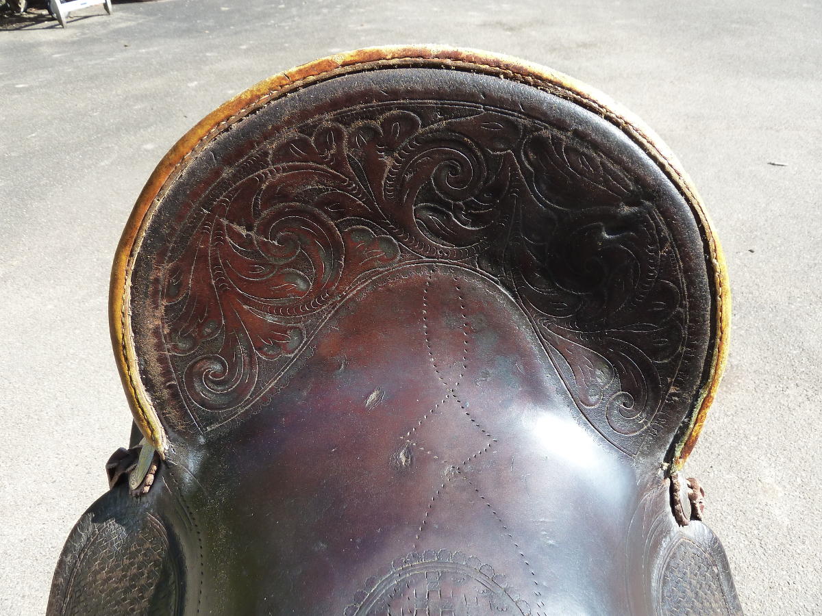

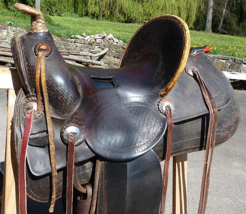

Hi I have an old saddle that needs some TLC and bringing back to life the leather is hard and dry and curled in some places , can any one help with tips and what to use to soften and make the leather a but more flexible? I was told lexol leather cleaner and lexol leather conditioner and the fiebings leather balm would be ideal no oils as this would harm and darken the leather any help and tips on applications would be appreciated .

This is a good old treasure and worth some TLC. While it may not prove to be too useful to ride (narrow gullet and bar configuration), it could be quite collectible. If possible, make a plastic tent and use a humidifier to get it rehydrated (not drenched) before you start putting stuff on it. Yes, it is terribly dry and as such won't take any care products very thoroughly or evenly. If you decide that it is too much for you be sure and take it to someone who will restore it vs repair. The good advice (and some not so good) should pour in on this forum. If you have the time, wait til all the advice comes in and then sort through it rather than just start jumping.

Hi is it possible to stop this crack from getting any worse and here are a few more photos. Thanks

In regards to your crack - it's sad to see a "sibling" to my saddle in such a condition but this is what one gets if it hasn't been cared for. From what I can see, your saddle is built a lot like mine, just different hardware. I would take it apart and strip it according to Wenny's suggestions.
One advice of caution should be given. Water will dry out your leather, just as oltoot was pointing out already. The straps would have to be replaced unless you want to use it for display only. Remove them carefully if you want to reuse them. The skirts should come off fairly easy. You might want to consider replacing the shearling. If so, you could recondition the skirts a lot easier as it should be done from both sides of the leather.

Decide first if you are going to use or collect because for collecting the more the original features are preserved the better whereas for use you might make some different decisions. For collecting don't replace the sheepskin as it looks to be original and not in terrible shape. You will be pleasantly surprised with how much the cracks will fade as the whole thing is brought back to life. If you are going to take it apart, wait until it is rehydrated and conditioned before subjecting things to stress. If you are going to replace the strings, just cutting them off close can make the stripping process easier. They look like they have already been replaced once so may well not be worth the effort to salvage them anyway. Try to find a maker's mark somewhere and do the best you can to read it. Then you might submit photos along with any UK history you might know to Mike Graham via the Western Horseman magazine to get a more complete history, value estimate and perhaps a little advice as far as restoration, etc
