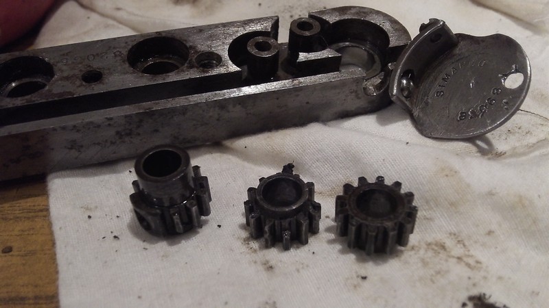

I had this issue with a 53 and it turned out to be that the bobbin carrier was sitting too high...I think the previous owner had "had a go at it" but gave up and sold it on.

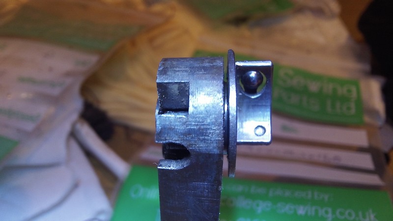

You should have no problems closing the cover over the bobbin...mine would just touch it and that turned out to be the problem. Also, make sure that the little bobbin tensioner thingy that you can see in the side of the bobbin carrier in pic 2 is not clogged with dirt and is working freely.

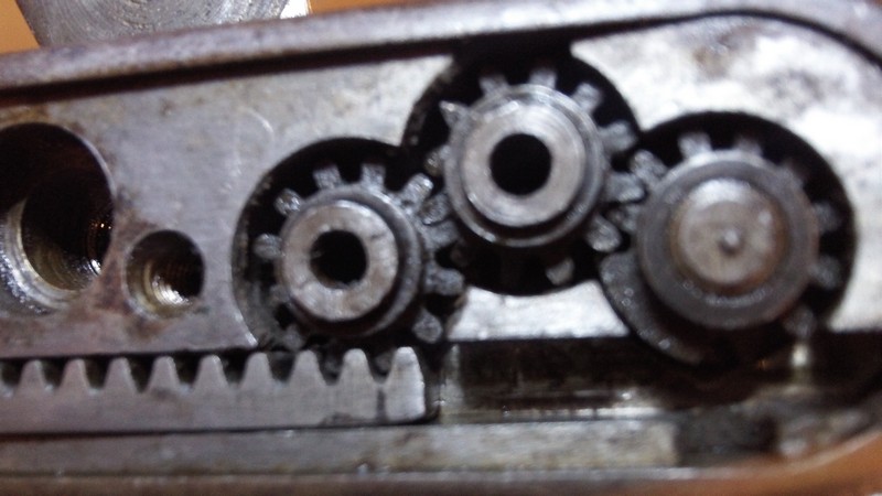

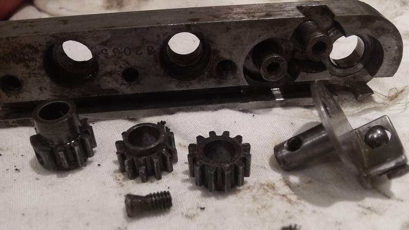

I did take a few pictures before I took mine apart to make sure that cogs go back into the arm in the right place so that the timing was still ok.

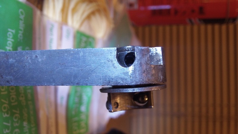

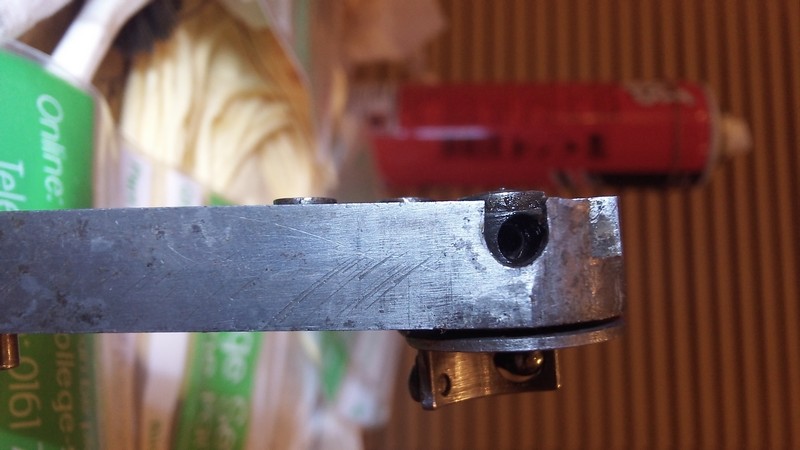

I will attach the pics as they may help you or others and pic 6 shows the gap under the bobbin carrier that caused the problems for me.

thank you for your advice,i have checked the clearance of the carrier and that is fine,but the tension spring is not good(does not move freely, catches on carrier),i have got it to move without catching but i will have to replace it,i didnt realise this spring could cause such a problem,i also greased the gears to help with any play and now it is stitching better,cheers,martin.
