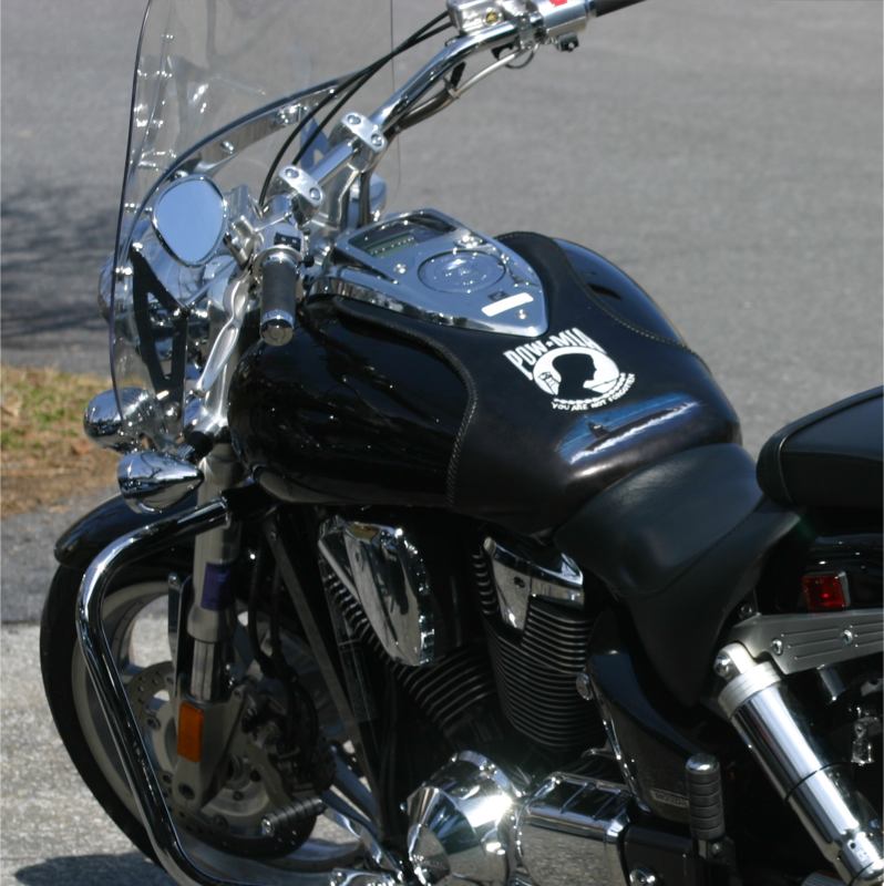

Here are some photos of some bibs I finished recently along with a couple of photos from the client's with the bibs on their own bikes.
Kind of nice to get pictures back after they are installed, about 3/4 of folks forget to send me photos once they are on. The POW-MIA bib is for a 2008 Honda VTX1800 F1 and the cricket bib is for a 2007 Honda Spirit 750. The last bib is medieval style tapestry artwork the client supplied of a gryphon, unfortunately the detail doesn't show real well in the photo. Cutting that one was a challenge as the lines were very small (1/8" wide in most areas) and very close together. The cricket bib photo of it off the bike with without top coat but after the painting was done so it's not as blended & shiny as the final product.

:You_Rock_Emoticon: awesome job! those are very well crafted pieces!
I'm not a biker person, so I am curious. How are these bibs held in place on the tanks?
Are they tied on at the seat area?
I really like the cricket one and the POW one! Great artistry!
Edited by GrampaJoel
Thanks Cuda.
GrandpaJoel - it's a combination of wet forming and velcro securing points. The bibs are wet molded to gas tanks I have in the shop so they are an exact fit for that bike and don't need much to hold them on. For extra security I add 3 sections of velcro, one under the dash panel and one on each side where it wraps under the tank. The ones under the tank help ensure the bottom stays put and doesn't loosen up in the wind. For the most part, the forming, the seat and the dash hold the bib in place very securely. Putting the velcro in those spots ensures that if the client takes the bib off the bike, there are no unsightly ties or velcro pads showing/out in the open.
