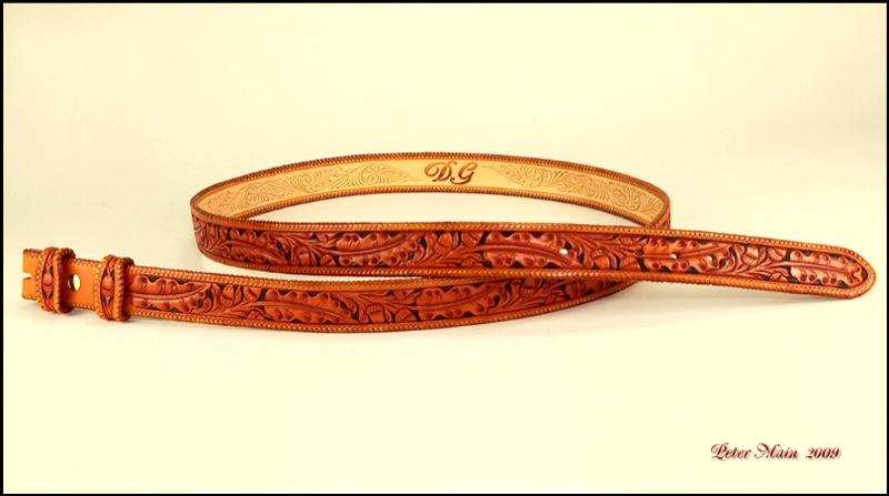

First photo
...the belt (1 3/8" wide) posted last week is now complete. It is colored with spirit dyes using a combination of brush and airbrush...the shading on the initials and scrolls on the inside is a all brush work. I has a filler inside to give a rounded look....looks far better than a 'flat' belt.

...54" WAIST...11 FEET OF LACING!!!!!
those are some nice belts.. Peter does such great work.. is the first picture the 54"er? thats a lot of be belt i hope it doesn't get covered up by a big belly. and no one ever gets to see it..

The 54"er is the one with DG initials.

THat is a very nice looking belt. Great idea with filling in the center to give it that slightly domed effect.
On the lacing, did he burnish it a little after the lacing was finished or was that from when he was skiving and rounding it before He actually did the lace job. It has a nice darker shade on the outside edge of the belt that looks really good.
Looks like alot of work but well worth it.

he did say he burnished a lot using a bone folder, but he also mentioned that he used an airbrush on some of the dying (i don't know which parts though).
i never get tired of looking at peters work....who would have thought that whipstitch could look so good

That is jaw dropping nice.
The lacing gives the effect of snake skin.
What would be the time frame on that belt.

It took in excess of a day (meaning 24 hours) to complete...(if you speak of the light colored belt with many flowers).
