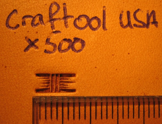

I have a question. I need to know the exact dimensions and a close up photo of 3 Craftool punches. they are X811 X502 and X500 please.
I have a basketweave machine and require a tool that I can finish the ends with. These of course want to be close to the size of the imprint. Many thanks anyone !!!
the ruler is in MM
Edited by Don101
Thanks Don much appreciated. Very helpful Cheers T
