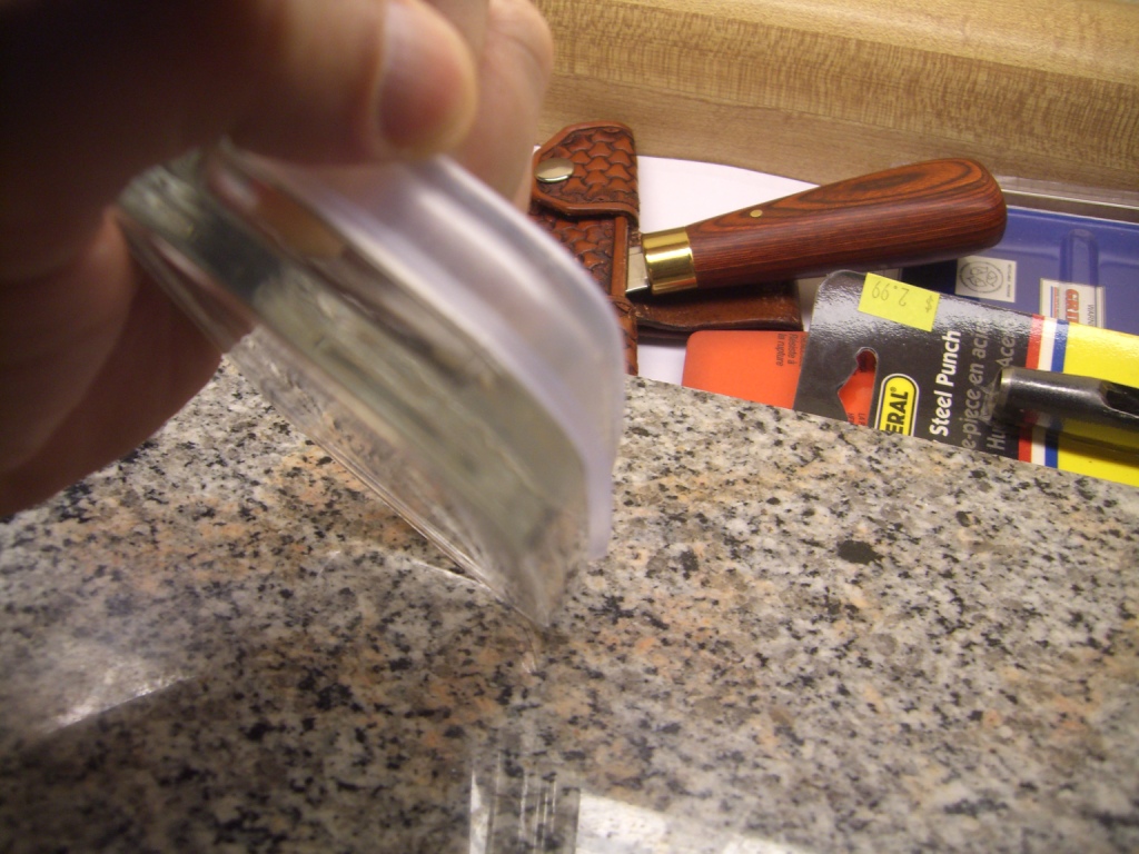

One of the members at the last guild meeting demonstrated a glass slicker for me. I really liked it, but need to slow down on buying anymore tools right now. I saw a candle in a square jar this weekend...
What is the best method for using a slicker?
I wet my leather and slick when it is still carrying some moisture but not quite to "tooling dry" look. Too wet and it mushes around, and too dry and it burnishes. I will push the slicker ahead of me in all four directions. I use a light pressure and maybe increase as I go. Just depends on the firmness of the leather. Too hard on soft leather and you can push a wrinkle ahead of you and that's no good. Some guys pull first, and then push as the leather compresses.
Adam - Check out a local glass company. I told the guy what size I wanted and what I was using it for. He had a thick piece in the scraps that he cut and polished the edges of. I asked him how much and he just gave it to me. It does not have a wooden handle on it, but is smooth all the way around so I can't get cut and it works great! Thanks Deb

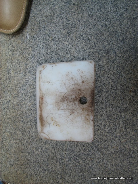

I am posting this reply under duress. Someone who has seen my shop wants everyone to know I did not always have a cool looking Barry King glass slicker. I will be outed if I don't show it.
I started off with a wooden one, and broke it. Hearing the old tale about cocobola dust being toxic I followed EPA/OHSA/HazMat protocol and properly disposed of the pieces. I have since been informed that is not necessarily the case. Looking around the shop (and keeping with the title of this thread) I found an old piece of LDPE cutting board. I cut a slab, ran the router around 3 sides to round it over. The router actually left a nick free smooth edge requiring no additional buffing or anything. It really worked pretty good and I drilled a hole to hang it up. I was always going to get around to making one from new cutting board that didn't have punch holes and dings on it, but never did. It has character. I used it exclusively a good 3-4 years, and still do for some stuff. It is good for swell covers. If you hit a nail or tack and ding the edge, just run the router around or run it over a 120 grit on the bench top belt sander and back to work. I use the glass one on the carving leather, but the plastic one still gets used some if it is handier.
