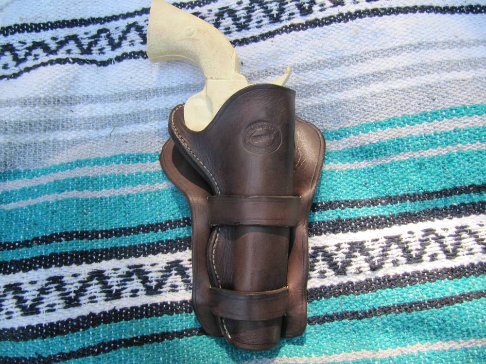

I would reccomend practice dying on some scrap if you have some. Many times the dye right out of the bottle will be very dark. You can cut it with alcahol until you get the shade you want. I have a hard time getting a good even dye job with a swab. THis is my personal way and it works for me, others mialage may vary. I use a sponge. I prefer the closed cell kind and cut them into about 2" squares. dab the sponge in your dye mix then lightly folded paper towel to distribute the dye more evenly and soak up an excess. I oil after dying. This helps to put nutrient back into the leather that were lost during the dying process.
Again I reccomend practicing before you do it on your project to make sure the process works for you. Below are a few pictures of items I have dyed using my method. Again there are many methods including dip dye, spray guns etc.
