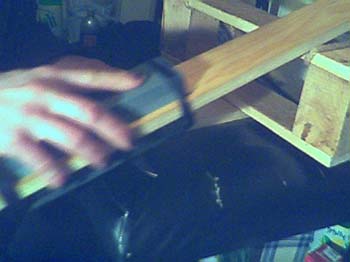

bang for the buck...
Jig made from wooden pallets, cheap stones, wet and dry or a second hand oil stone, leather which we all have some of, boot laces and toothpaste.
ALthough really toothpaste sucks in long term use.
I can't seen how the jig works. Too dark a picture on my screen. Is it just me?
SkipJ
If you look under the stone you will see the knife blade poking out.
The stones are tied to the wood which slides ontop of the rack right side, the rope on it is to keep it alligned perfectly,
You slide the wood/stones over the blade curing around the belly, back and forth back and forth.
You work that till there is a burr, then change sides...
That clear it up any?
If it doesn't go to youtube and look up cutlerylover, he has an excellent demo of the edgepro apex...
