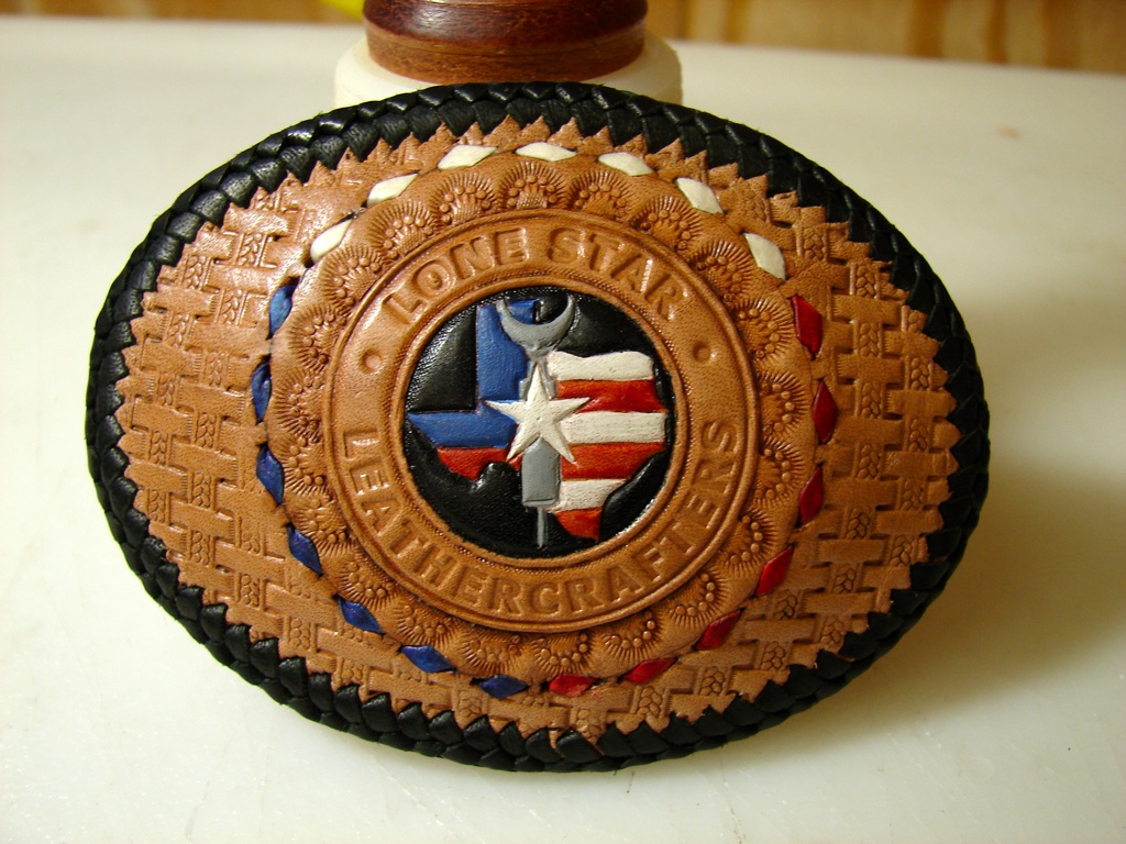

Here's a buckle I completed for a competition sponsored by Lone Star Leathercrafter's Guild. I won 1st place with a prize of $50 donated by Leather Crafter and Saddler's Journal.
Thanks to all that voted for my entry, and all here on the site that share lots of knowledge for the benefit of us all.

Very Nice. I like the lettering. I don't recognize it as a Tandy set. Where did you get the letter stamps?
Hi resqman,
That is a custom made stamp, for the Lone Star Leathercrafter's Guild. It contains the letters, the state of Texas, the star and the swivel knife.
I really like the lacing surrounding the logo stamp the coloring in it really blends it into the logo coloring and design.
Did you use natural lace and dye it or splice the 3 different color laces?
Hi,
I used bleached rawhide lace. It's very thin, probably .5mm and it was dyed and dried prior to buckstitching. It is three separate pieces with the ends glued in place on the flesh side of the leather.
love it ouffff, i got a friend that need a bukel whit no metal to it i think this would do
can you tell me how you did this i would try to copy it if you dont mind
just writhe me on the site please
thank you very much
Hi,

Unfortunately, this buckle does have metal on the inside. It's sandwiched between two layer's of leather. I used an oval buckle blank that you can get from just about any leather supplier. I tooled the front, then I used contact cement to glue the front to the buckle, then do the same for the back, using a bone folder to 'mold' the back piece to conform to all the creases. Then laced her up. That's it.
